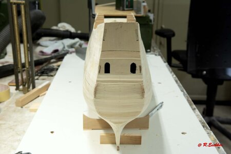

Hello everyone,
The anchors with the anchor buoys have been attached.
The flags were raised. The quality is not great, But what the heck
And finally, the rear lantern was fitted.
So that's it, there will be no continuation.
After about 3 years of building, after a lot of swearing, rebuilding and a patient wife, the model is finished.
I would like to thank everyone who supported me with criticism, advice and encouragement to realise this model from a subscription kit.
Thanks again, thanks, thanks.
Special thanks go to Fred Hocker, who gave me the courage and perseverance to complete the model.
I don't know at the moment whether I'll take any more pictures for the gallery.
I'll probably start by organising a nice display case.
Greetings
Rüdiger
