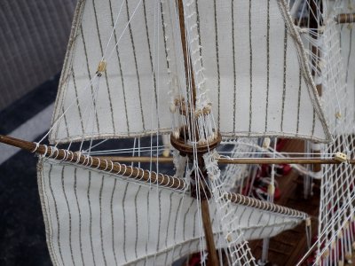

At the request of @Bobby K. a reconstruction with photos and what I still remember is started
Billings instructions are mostly followed.
Modifications
The keel and bow sections are made of solid wood.
The plywood deck, with the printed planking, has been replaced by a prefabricated solid wood section.

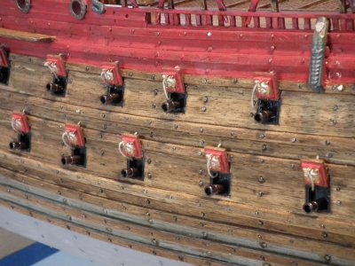

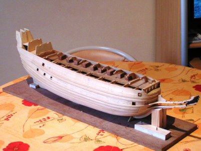

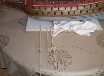

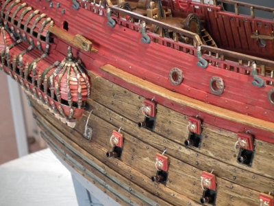

According to the kit instructions, gunports are supposed to be glued to the hull. I did not think this was a good idea, so they were placed inside the hull. Wooden blocks were glued into the hull as support for the half-cannons. This later proved to be an awkward solution and not one I would repeat.

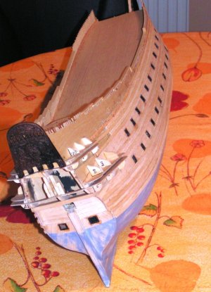

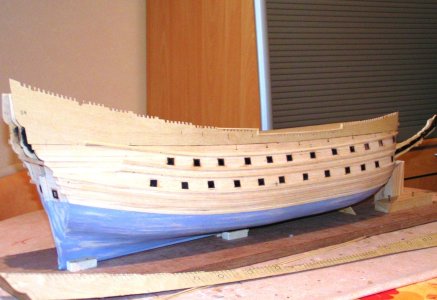

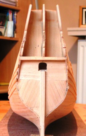

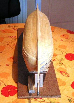

Hull, further construction

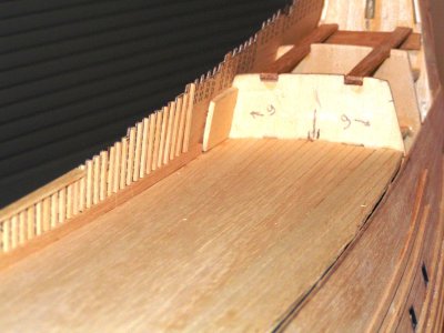

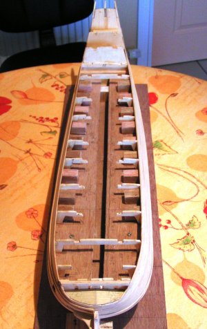

Here the first plywood sidewall has been installed. The frames are being glued onto the inside of this according to Billing's instructions. The new deck plate is also visible; I no longer have any idea who the manufacturer was, and the shop where it was purchased no longer exists.

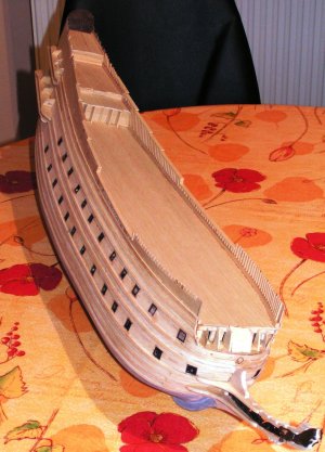

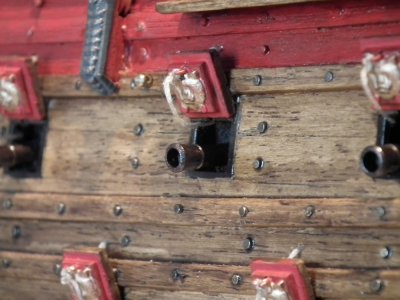

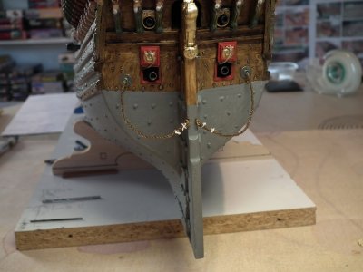

The plastic gunports from Billing's have now also been incorporated into the hull.

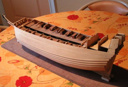

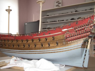

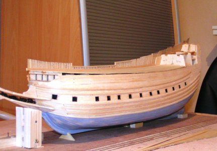

And below the waterline, a first grey coat. And yes, white would have been better.
Given that wood is not affected in the cold Northern waters, the underside of the original was probably not painted. But my planking knowledge wasn't that good back then, and this was an ideal camouflage trick.

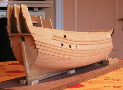

The transom is also starting to take shape.

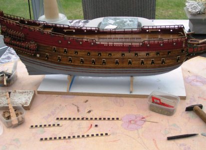

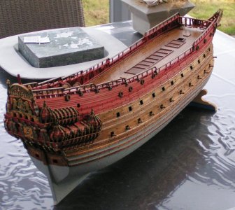

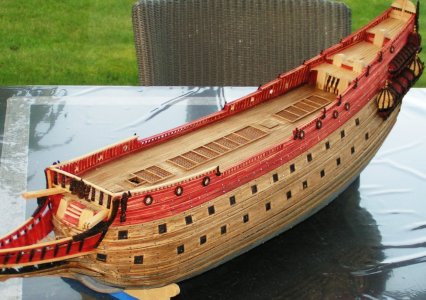

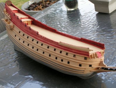

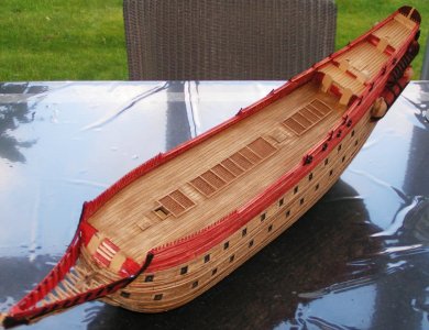

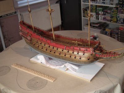

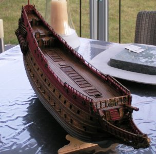

In this update, the hull is completed.

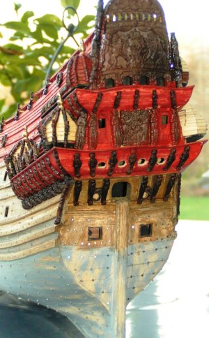

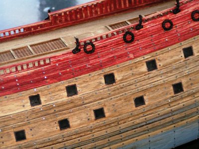

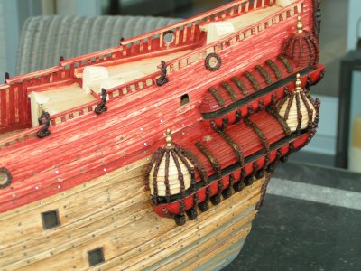

A first coat of red and varnish (old oak color) has been applied and sanded.

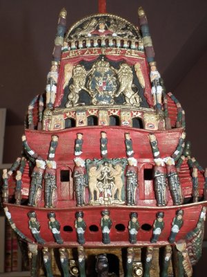

The plastic ornaments come from the kit. Not all of them match the original model. They are all flat, and some need to be bent; I did this by carefully holding them over a burning candle for a moment. Then I bent the ornament into the correct shape on the model.
There are also (too many) nails/bolts installed. Just bolts in the wales would have been much better.
At that time, I had no idea what tree nails were.

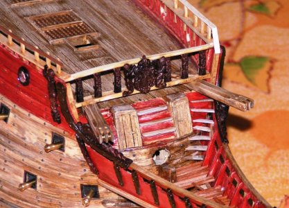

In the lower gallery on the transom, holes have been provided where swivels could have been placed.
