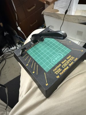

The top of the list for cut off tools...The material provided for the rib stiffeners appear to be 1/32 x 1/16 x 12. The plans say to use .02 x 1/16. So I am only sanding off about .01 of the thickness. It may be more trouble than it is worth. Besides, every piece of strip wood that came with the kit is not accurate according to the parts list. I may end up using the strips as they are.

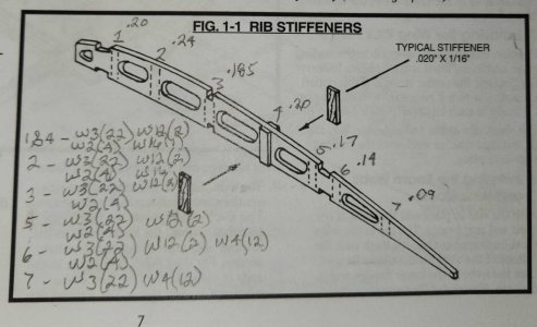

I do have a second question about cutting all of these rib stiffeners. I am estimating that I need to make about 300-500 cuts. Maybe a bit more, as I have not added up all that are shown on the drawings. Is there a tool available to purchase or possibly make to make this step easier? I need a cutoff blade and a fence stop so that I can butt the strip against the stop along the fence. I really do not look forward to trying to measure out each piece. I did three wing ribs by laying the strip across the rib, marking it with a pencil and then cutting the strip with my exacto knife. None of the pieces are the same size as I can barely see the mark or the cut, with my poor eyesite. LOL
That thin and small, I might suggest just using card stock painted with acrylic paint to match the wood.I am not sure what you mean by cap strips. These are rib stiffeners used on the wing ribs. They provided 1/32" x 1/16" x 12" basswood strips, but actually say to use .02" x 1/16" x 12 for the stiffeners. So, I actually tried to sand down the strips to get them closer to .02" in thickness. It is very time consuming, which is all I have anyway. LOL Also, the strips have to be cut to different lengths based on which part of the rib they are located. I have attached a picture of one of the multiple ribs from the instruction manual. There are about 12 othere ribs of differing lengths and design. So, I am guessing I will have to cut 500+ strips down to correct length for this model.
Wow, $175 may be a bit more than the Admiral has budgeted, but thanks.

in addition, 0.5 mm is even closer to 0.020 inch. Do a search for that size online and there are quite a few sources are provided.![]()
I agree.1/32" down to 20 thousandths of an inch isn't much... that's only a difference of .011"
I'm usually a stickler for true scale, within 'doable' reason, however. In 'this' case I'd personally be hard pressed to just leave those strips at 1/32" thick. Those ribs are going to be really 'busy' looking after all is said and done. I'm not so sure that a difference of .011" will even be noticeable. Just 'my' opinion, of course.
Cap strips go along the top edge of the rib and help to prevent the top covering material from tearing due to wear against the top of the rib. It works by spreading the contact surface area over a larger area.I am not sure what you mean by cap strips. These are rib stiffeners used on the wing ribs. They provided 1/32" x 1/16" x 12" basswood strips, but actually say to use .02" x 1/16" x 12 for the stiffeners. So, I actually tried to sand down the strips to get them closer to .02" in thickness. It is very time consuming, which is all I have anyway. LOL Also, the strips have to be cut to different lengths based on which part of the rib they are located. I have attached a picture of one of the multiple ribs from the instruction manual. There are about 12 othere ribs of differing lengths and design. So, I am guessing I will have to cut 500+ strips down to correct length for this model.
