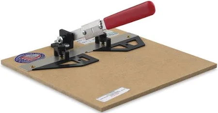

Micromark sells a cutter to cut strips from veneer, I did that with success to make hull planks from walnut veneer.
That is a great tool. I have also seen DIY builds of the same type of tool.
