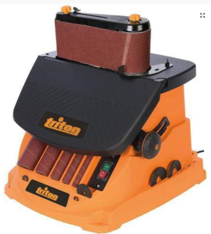

Since I have ample sheets of pear I just made it easy and ripped strips to use.
when glued I clamp the ribs tightly to insure best bond and have had zero failures when beveling, all done on the spindle sander which really exerts very light pressure to get the job done.

Tim you and Jeff have both mentioned your "spindle sanders", anyway you guys can tell me which ones you are using?
