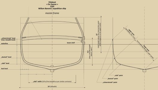

The conceptual reconstruction of the vlieboot ‘De Zwane’ will be based in particular on a contract for the construction of a vessel of this type dating from 1592, which contains most of the key numerical data and which, amongst a number of other surviving shipbuilding contracts from those years, is considered to relate specifically to the vlieboot ‘De Zwane’.
It should be noted here that previous ship reconstructions, based on these early Dutch contracts from the turn of the 16th and 17th centuries, have not been entirely successful, as they have encountered a difficulty in interpreting the numerical data relating to the hull height that has so far proved insurmountable. The point is that the values given in these early contracts were interpreted in a manner now accepted for later decades, so to speak within a structural rather than a conceptual paradigm, which did not allow even generally correct hull proportions to be obtained; in particular, the ships would have had far too little draught in relation to the height of the superstructure (they should be more or less equal), nor would it be possible to add the ‘mandatory’ weather deck above the main deck (whether in the form of a light grating deck or a slightly more robust koebrug), even at the cost of bringing the gun ports right down to the waterline!
On this specific point, a solution is therefore proposed that is closely based on the recently identified Dutch design methods within the broader Northern tradition (illustrated, for example, by the design of the frigate Wageningen 1723, https://shipsofscale.com/sosforums/threads/dutch-frigate-»wageningen«-1723-—-a-couple-of-decades-ahead-of-chapman….18387/), which resolves the previously insurmountable problems mentioned above. Indeed, the proposed solution coherently reconciles all the fundamental requirements for this case (and others):
— a depth of the submerged section no less than that of the unsubmerged section of the hull in the midship region, which is one of the most important factors influencing the weatherliness or its lack of a seagoing vessel,
— sufficient height of the hull’s above-water section for a double-deck configuration,
— the correct position of the hull’s maximum breadth in relation to the waterline from the point of view of the ship’s transverse stability, a circumstance known to shipwrights of the time (here a fairly typical distance of 2 feet above the waterline),
— sufficient distance of the gun ports from the waterline (here 4 feet, suitable for smaller and medium sized vessels of essentially non-military purpose).

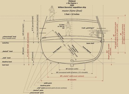

Furthermore, the proposed interpretation has a direct impact on the shape of the master frame itself, in a sense facilitating the identification of its realistic contours, as intended by the vessel’s designer (note: nevertheless, some elements defining this contour, such as the position of the ‘boeisel’ point or the extent of the tumblehome, still had to be inferred; similarly, the width and height of the ‘vlak’ were proportionally derived from other contracts of that decade for vessels of the same type).

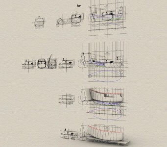

Strictly speaking, this is only the beginning of the work, but I think that the initial results can already be presented. Hopefully, the diagram below is clear enough in itself and requires no further explanation; nevertheless, it should be clarified that the proposed interpretation of the following provisions in the contract is as follows:
„… diepe derthyen voeten” (depth 13 feet) as — the side height above the intersection point of the tangents to the upper conic,
„… de bantwegers […] gelecht aen weder syden aen boort, op negen ende een halve voeten...” (beam shelf fixed on both sides at a height of 9.5 feet) as — max. breadth height above „vlak” level 9.5 feet.

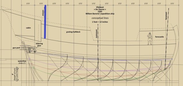

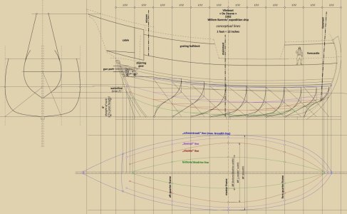

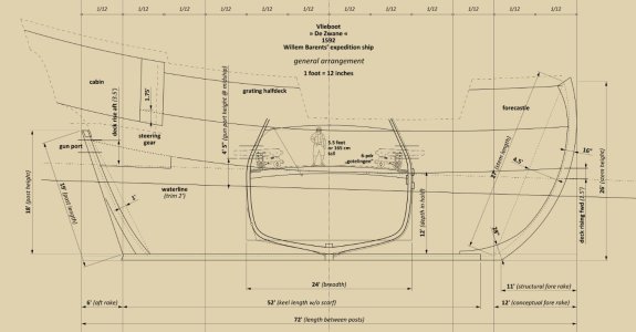

The attached illustration, which can be seen below, is a preliminary, simplified conceptual sketch, arranging the design elements graphically in accordance with the data contained in the contract for the construction of ‘De Zwane’, partially supplemented with dimensions taken from contracts from the same years (i.e. 1592–1594) for vlieboots of the same size.

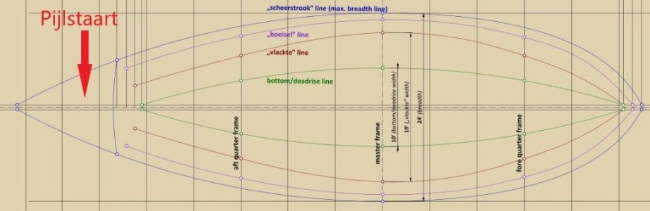

First and foremost, it will be argued that the true length (between the posts) of Barents’ vlieboot was not 69 feet, as obtained in previous reconstructions by simply adding together the lengths of the keel and both rakes specified in the contract, but 72 feet.
Adopting this second value, which is three feet greater, means that the reconstructed vlieboot has ‘standard’ hull proportions – precisely 6 : 2 : 1 (length : beam : depth), or, if preferred, 3 : 1 : 1/2; furthermore, both rakes are round sub-multiples of the hull’s breadth (namely 1/2 and 1/4 for the fore rake and aft rake respectively).
Or, expressed in dimensions:
Breadth (moulded) — 24 feet
Length (between posts) — 3 x breadth = 72 feet
Depth in hold (from keel to deck) — ½ x breadth = 12 feet
Fore rake (from fore vertical to stem rabbet) — ½ x breadth = 12 feet
Aft rake (from aft vertical to post) — ¼ x breadth = 6 feet
A possible reason for this apparent discrepancy in total length may be that the keel length was taken from the design drawing and specified in the contract only for that part of it which had a full cross-section, that is, without taking into account the scarf that joined the keel to the stem, and this is clearly not an isolated case where the sum of the keel and both rakes does not match the stated overall length.
Furthermore, the stem rake was most likely taken from the design drawing (and its value recorded in the contract) in the same way as the stern post rake is measured, that is, structurally rather than conceptually, i.e. for the latter — to the rabbet line (see diagram).
Generally speaking, it can also be noted that this method of notation — which is not so much arbitrary as it is one that overlooks conceptual issues and focuses in particular on clearly visible and, as a result, well-understood structural, fitting-out or decorative matters — is predominant both in the written contracts of the time and in today’s descriptive commentaries, even by experts in specialist publications discussing design drawings from the era. The very few exceptions essentially confirm this, it seems, ever-relevant phenomenon.
In this reconstruction, for the assumed deck height of 6 feet, the hull height at midship equals the ship's draught, the stern height is equal to twice the draught, and the height of the forecastle is equal to one and a half times the draught, which is almost perfectly consistent with the general, categorical recommendation in the so-called Newton manuscript from the first quarter of the 17th century, naturally closely related to the ships’ weatherliness and transverse stability.
Contracts from those years specified the length of both posts, measured diagonally relative to the keel (see diagram). Their height, measured vertically and also shown in the diagram, is the result of an appropriate conversion.
In the reconstruction, the deck rise in the aft section of the hull (3.5 feet) and the trim value (2 feet) were selected such that it proved appropriate to incorporate a step in the deck with a height of ‘approximately’ 2 feet, as mentioned in the contract, for a logical arrangement of the stern section, with particular regard to the steering gear, for the stern post length of 19 feet specified in the contract (which translates to 18 feet in height).
The dimensions and height of the gun ports above deck were selected to accommodate 6-pounder cannons, as this appears to be the maximum calibre of the guns issued as part of the ship’s preparations for the expedition, judging by their weight as stated in the ‘De Zwane’’s’ outfitting documents (1,600 pounds).

If anyone has any substantive comments on this matter, now is a very good time to share them. Incidentally, judging by the content of the inventories provided by @Heinrich — which appear not to have been exploited in previous reconstructions — I expect that this is not the end of the surprises regarding the features of Barents’ vlieboot .
Dear Waldemar. Now you have really me excited for a variety of reasons!
I know that what I am about to post is going to sound very unscientific and illogical, but when you have been busy with a particular type of ship for as long as I have and have been exposed to the number of renderings that I have, you start developing develop a certain "gut feel" of what the model should look like. The moment that I laid my eyes on your rendering; I knew that this was it!
There are three points I would like to mention in particular. Firstly, the draught of the ship is considerably deeper which adds proper substance to the hull. No longer is the height between decks 1.4 or 1.5 meters which would have been nothing more than a crawl space. Secondly, the substance makes the build-up around the forecastle area look much more integrated with the overall hull design than on any other interpretation. This was something that irked me on both the iterations that I built - the forecastle always looked like an add-on, never as if it was part of the ship. Lastly, gone is the exaggerated high build-up at the stern which I have posed serious concerns of the weatherliness of the ship.
The one aspect that I have to wrap my head around and which is new to me is the difference between the structural and conceptual dimensions. I simply cannot believe the impact that it makes on how the model is perceived. I am, however, slowly getting there (remember you are dealing with an English teacher; not a draughtsman or engineer!)
Lastly, you are so right when you say that the contents of the inventories/contracts have never been explored before - and goodness knows why not. They have always been there - all that was needed was proper research!
