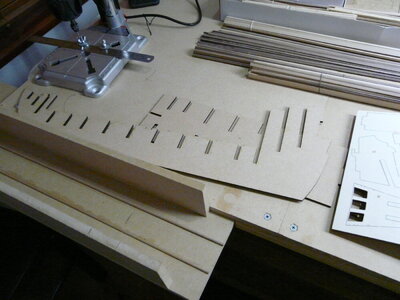

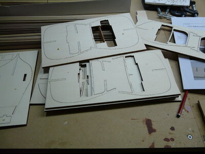

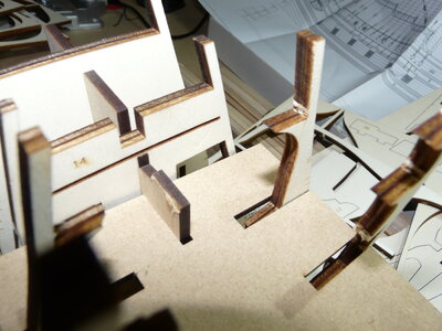

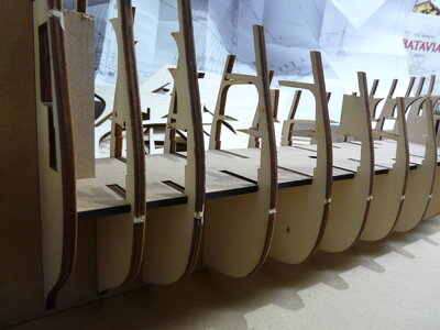

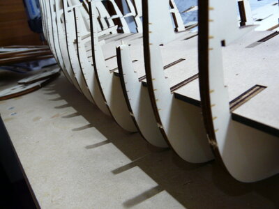

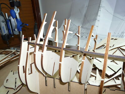

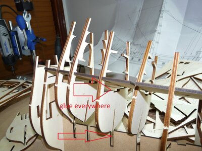

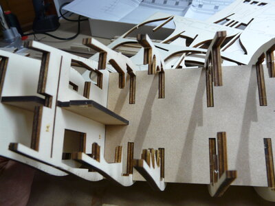

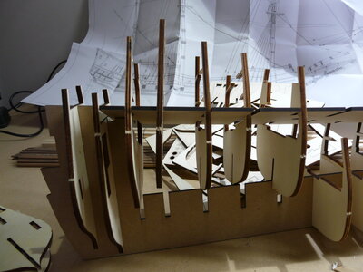

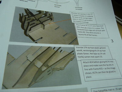

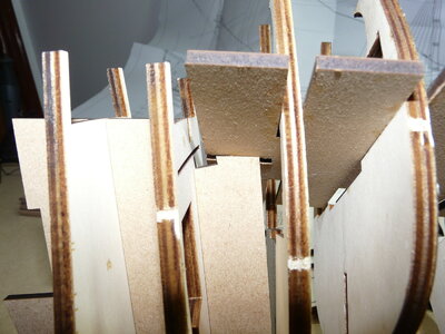

Ok, just had a look at my initial pics. Big deal. Seriously, get on with it. I have only done 2 kits prior to this kit, so bear with me. I must say , everything, thus far, fits beautifully, my last kit (Occre, Revenge) had only 4 mm bulkheads, the Batavia has 6mm bulkheads, I'm loving it. I found that the best way to fit the quite tight lower deck , is not to try and sand the parts that were too tight and try to push it all down, risking breaking off other pieces. I just lifted the bulkheads, fit the deck, fiddled around, glued the lot and pushed it all down. It worked, maybe not to schedule but I found it worked. I take my hat off to Kolderstok, the fit could not have better. My bulkheads did not need any assistance as far as extra blocks. The fit is tight and so impressive. There were one or two casualties but I'll take that.

Looking good Frankie. My advice is to extend the guiding lines for the planking on the bulkheads. Also, extend them to the back of the bulkheads. You are so right - this kit redefines solidity and fitment of parts.
Heinrich, believe me, I have done this kit well differently to the norm, it's been an experience. It's the way I interpret things. Like I plank the gunport level first and then adjust/sand the ports and boxes , fit them, I'm not sure of how it will turn out.
