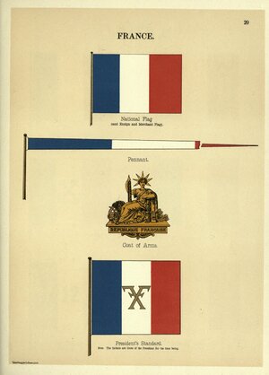

In the meantime I found in a publication how big the flags and pennants were.
Here I show excerpts of this book - LE GRAS, M.A.: Album des pavillons, guidons, flammmes de toutes les puissances maritimes- Paris 1858 :
In the meantime, with the help of a fellow modeler, I was able to clarify what the column marked with a question mark means. This means the fabric web width, which was accordingly 50 cm. Thus, after correctly classifying the type of ship, the sizes of the flags and pennants can be determined.
Accordingly, the large pennant of La Creole was 16 m long and the width was 15 cm.
The pennant/tricolore was divided as follows:
Starting at the masthead 20% blue, 20% white and 60% of the length waving red.
