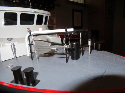

I use the material that that is used to tint automotive glass applied over the clear acetate for the windows. It is available from any custom automotive store and easy to apply as it is adhesive on one side.
