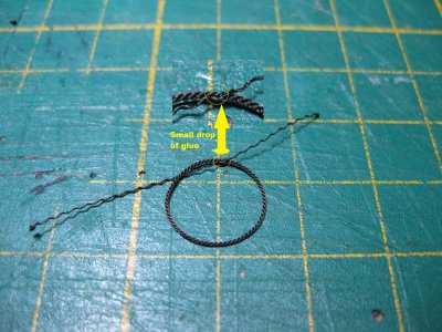

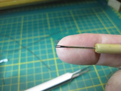

That depends on the rope you use. Cotton likes diluted white wood glue. And polyester rope responds best to thin superglue. I have a fine sewing needle to apply the glue. I inserted the needle with the pointed tip into a wooden rod to create a handle and I cut the eye in half. So that this becomes a tiny fork that I use to pick up the glue. This way I can dose very precisely on the knot. The excess glue I remove immediately with the fingers FAST. This immediately removes any shine. You don't need much glue, just enough to keep the knot in shape.
This is the largest eye needle, I have ones that are even smaller and I use them more often.

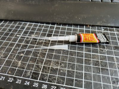

This is a tough one. If used properly, and with an applicator such as 'THIS' super-thin Ca glue can easily be applied, very sparingly, without frosting... as the frosting 'typically' occurs when too much glue is applied. That's not 'always' the case, but 'minimal' is a good general rule of thumb. Clear nail polish is another good adhesive for things like this. I learned the nail polish trick from back when I used to tie trout flies for fly fishing. Thinned PVA is good also, but 'thinned' close to water consistency is the key. As with 'all' adhesives, go easy! Too much glue will 'shine' once cured. If you 'want' a sheen, slather it on. If you 'don't' want a sheen, use just enough to get the job done. Less is usually 'more'! It really doesn't take as much glue as we typically like to 'think' it does!
