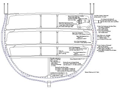

So perhaps you could tell me what was between the outer and inner planking? Between the frames I mean. How did the crew repair an outer hull damage below the water line? The whole art of ship building is so intriguing to me I find this forum so fascinating, and my friends think I am nuts for trying to attempt it. All and allIn the hope of your not remaining a novice forever, let me say that those are just frames. Not "bulkhead frames." Bulkheads are nauticalese for "walls." "Ceiling" is the inboard planking hung on frames. It's confusing, I know, but the sooner you are able to pick up the language, the easier ship modeling becomes.It's no different that houses, which are built with "siding," "framing," and "drywall."

What's between the outer and inner planking is basically air. The "ceiling" (inner planking) does add some additional strength to the hull, but its most important purpose is to aid in the stowage of cargo, providing a smooth "wall" to pack cargo against and prevent its getting wet from leaking outboard plank seams. It also provides something of a ventilation system with air circulating unimpeded from the bilge up to the underside of the deck. Ceiling isn't generally carried all the way down to the keel but rather ends below at the level of the lowest deck "sole" (floor) and ends above a bit below the deck level. Additionally, in some ships and boats, there will be perforated "salt shelves" or "salt boxes" between the frames which are filled with rock salt. The purpose of the rock salt is to prevent fungal decal of the wood ("rot.") Wooden ships' holds are pretty humid, if not downright damp places and the fresh rainwater from above would absorb the salt from the salt boxes and prevent fungal decay. Wood decaying fungus requires stale air and fresh water. By keeping the air moving and the damp salty, the prerequisites for "rot" are minimized. Sailors called this practice "pickling the ship."So perhaps you could tell me what was between the outer and inner planking?

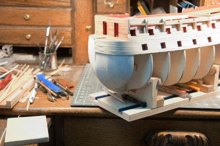

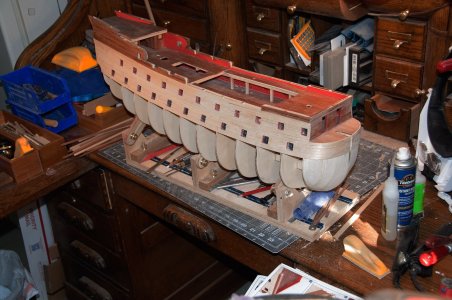

I am not familiar with “tick strips” or “the fan”. Would you please elaborate or point me in the right direction?The knee of the head can go on later but as the stem is a part of the bow and the planking seats in the rabbet in the stem on the actual ship, the stem had to go on first. For the kit, I am guessing you have choices.
I have always found using tick strips to mark out the width of the planking at each frame or bulkhead works very well but many have found the fan to be a great help as well. With 20 or 30 strakes of planking below the wales, it would be a lot of eyeballing and asking for trouble.
