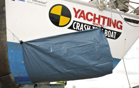

The most common serious hull leak repair is called "fothering." A "fothering mat," at its simplest is a piece of canvas or a sail that is placed over the damaged area, being held in place by lines tied to its corners. On some occasions, "tow," wood shavings, and the like was thrown into the water between the fothering mat and the hull in the hope the water rushing into the hull would cause it to clog the hole. Sometimes, the canvas mat was two-ply with tow stuffed between the layers like a quilt to thicken it and provide more resistance to the water. ("Tow" is the broken bits of fiber from natural cordage that continually rained down from aloft on sailing ships and was regularly swept up from the decks. It was used for this purpose, as well as to make oakum for caulking when soaked in pine tar.) In some instances, purpose-made fothering mats consisting of multiple layers of tarred or waxed fabric were stowed aboard for emergencies. The lines on the mat's lower corners are passed under the keel and the upper corner lines are tied at the rail, sort of like a big "band aid." This fothering mat is held in place against the damaged planking by the pressure of the water, thereby slowing the leakage to a rate with which the ship's pumps can overcome. With the fothering mat in place, reinforcing repairs with wood can be done from inboard. The ship's carpenter would have had dunnage (wood for bracing cargo and general use on board for repairs, etc.) on hand for such use. Once the pumps were keeping ahead of the flow, additional fothering mats could be placed over the damaged area and battens perhaps nailed to the fothering mats to keep them in place. Pine tar could also be slathered over the fothering mats to impart greater impermeability.

Modern fothering mat:
