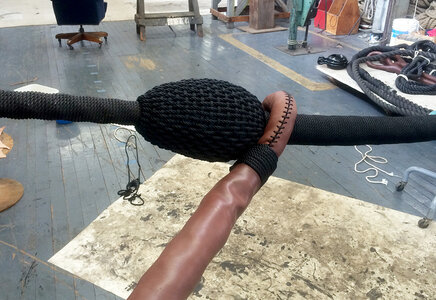

Also, @WarrLight , I notice that the line you are using for the serving (wrap) is quite large. It appears to be roughly the same size as your shroud rope. The marline would be a tarred twine and would be a fraction of the size of the shroud being served. See this image of the stay from the USS Constitution, and you can see the small size of the marline serving in comparison to the diameter of the served rope:
26-IMG_3141[1].jpg :
View attachment 192638 :
Excellent illustration of the question in issue. thanks. Rich (PT-2)
