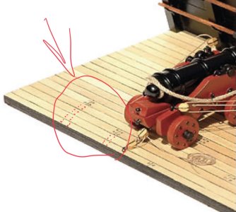

While the planks were secured to every deck beam with spikes and covered with wooden plugs The wood was the same species as the deck planks so barely visible. At our scales, many feel it is better to show none at all rather than having them stand out because of the color contrast with the planking.why arent the spikes shown on every board across every deck joist.
That makes sense…I was going to mark many and after one column I really didnt like all that many…sand paper to the rescue!While the planks were secured to every deck beam with spikes and covered with wooden plugs The wood was the same species as the deck planks so barely visible. At our scales, many feel it is better to show none at all rather than having them stand out because of the color contrast with the planking.

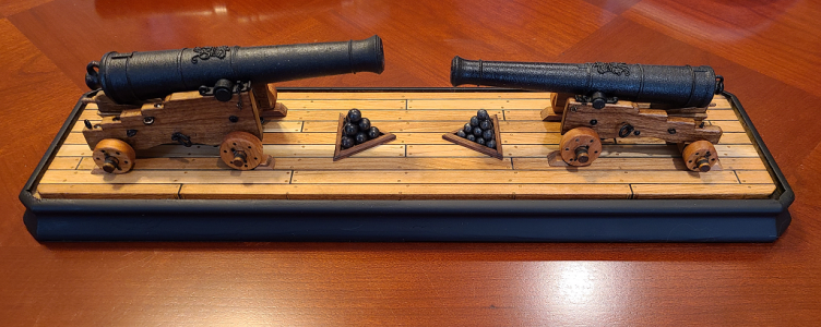

Visible deck fasteners is a popular kit convention. A convention that in no way reflects what an actual ship would look like from the distances that model scales represent. But that will hold true for much else with a kit.
I like the idea of using long dowels to secure both deck planking and hull planking - they are belt and suspenders and they can be excellent clamps for the building of it. The problem is that a useful dowel shows end grain. All end grain is too dark.
