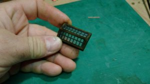

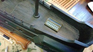

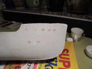

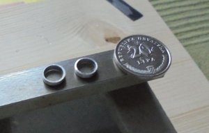

Can somebody tell me what is good way to imitate the glass on the window. I have made the frame of the window (Al pipe with inner diameter 6 mm). Is there some plastic mass to drop it in the frame?

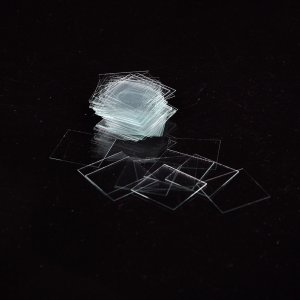

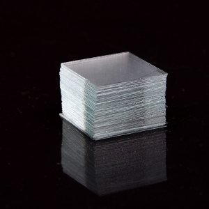

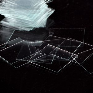

Some more info on what I shared
Specifications:
Size you can choice : 18mmx18mm
Thickness: 0.006" (0.13 - 0.17 mm)
Zoly, thank you for the advice. Yes, this solution can be also tested. And the cutting is tricky, I agree. :)

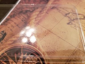

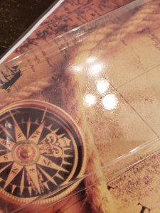

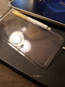

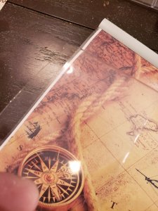

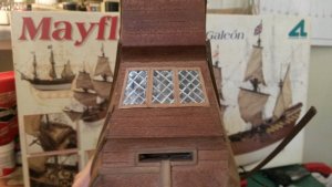

One thing you have to remember when making window glass from clear plastic or actual glass for that matter is that back in the time frame when wood ships such as we build sailed the seas the glass was blown glass which meant it had inclusions such as air bubbles and waves which also meant it wasn't very clear like we have today.
I learned this when I volunteered my help to renovate an old home from '1702' the windows had mixed glass of original and new and looked really bad. We had to find an old school glass smith to remake all the window glass for that house so it would match what was original. So if your going for that true Authentic look not just any plastic or glass will do. Over the years I have searched for the decent plastic to use as old blown glass and the best I have found comes from the packaging of BSI CA glue and Accelerator. I have used this glue for years to build Planes, Ships, Rockets ect. so I have amassed a nice collection of this plastic. included are some picture of the Plastic from that packaging as well as some clear plastic from other packaging. hope this helps.
BSI package
BSI Package
Random Package
BSI
Random
