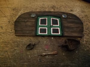

I started building this kit by making the front wall of the rear cabin called ''Løfting'' in Norwegian, and manufacturing two water pailers ''ausekar'' and a fish gaff ''fiskeklepp''. I made the doors openable as i want to have the interior of the rear cabin visible too without having to lift the whole cabin off.

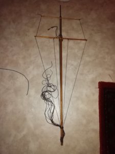

And i built the mast and most of the rigging ready.

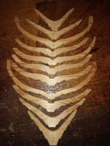

I re-made all the fuselage formers, as the originals were too asymmetric to use, and they were made of plywood, which doesn't look nice.
These ones are raw, un-shaped ones. I will shape them better just before attaching them to the keel. Also, i managed to already break the tip of part 4 off, but i will attach a new piece to it later on.

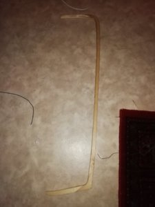

I also built the rudder and steering rod ready waiting for the brass fittings.
I roughly shaped the keel of the boat, next up is sanding it to final dimensions and then i have to jump into the scary part, which is gluing the formers to the keel and sanding them without breaking. then i have to tackle the planking of the hull, which is probably gonna be difficult to get looking nice and tidy, as it needs to look nice from the inside, too.

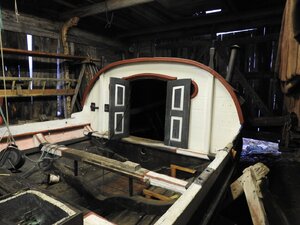

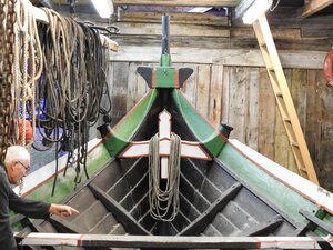

Maybe i will now finally get this kit forward, i just visited arctandria kystlaget's boat group to gawk at a real nordlandsbåt and took some detail photos of it, and i also visited Tromsø universitets museum and bought a book about building and history of these magnificent ships, and also five different sets of drawings for these boats. no, six sets of drawings :D
