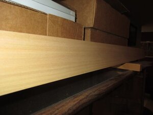

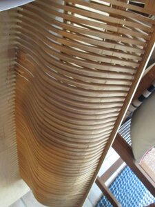

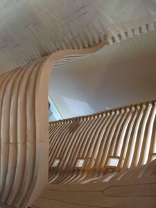

Speaking of boxwood...last year I got a 3" x 4" x 3' boxwood billet. I then sliced it into 3" x 1/4" planks. From these 1/4 inch planks I cut frame parts for a frame model of the Roebuck hull in quarter scale. (Actually still working on this...it is an on again off again side project) Very nice wood to work with!
This photo is a 1/4" boxwood plank. Notice the fine grain and consistent color.
Since I mentioned how I used the boxwood planks here are two sideways photos of the Roebuck project using boxwood for the frames.
Nice, Jim! Why have you been hiding this from us?
