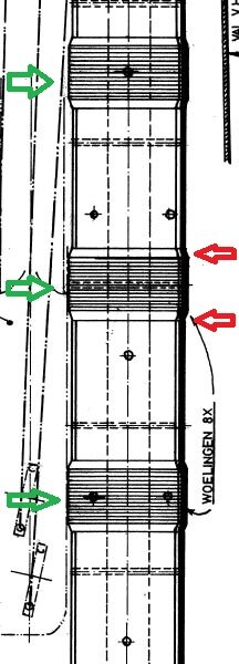

Hi, I have a question about the wood above and below the wooldings on a mast.
The red arrows are the wood pieces.
Is there some kind of a trick to create these things?
The size is about 1,0 x 0,5 mm and the diameter of the mast is 12 mm.
I tried veneer from swamp walnut (0,6 mm thick)
But that was no success in making
Tips are welcome.

@Jimsky thanks for the explanation of the use of wooldings. But I want to create these timber hoops on my model. I like these little things to complete a model. But only if I find a way it will look nice. Have you ever made these on a model and what was you're way to construct them?
Thank you, if you have a lathe, you can turn them from a dowel of suitable diameter. Drill the inside hole diameter a bit smaller than your mast. Using the fresh knife blade #11, while the lathe is ON slice the rings. This is the same way, I am doing the mast rings.
I'm just guessing here, never have made these wooden rings that support the edges of the woolding wraps, but perhaps you could get some copper tubing, cut a ring, file the chamfer on the outer surface, and stretch the ring on a mandrel so they have a slight press fit on your mast. You could blacken them if you need iron hoops or paint them. These wooden hoops are so small that on a model you could even form them from putty at the edges of your woolding and paint over or stain them. Any logical solution would look good. Just keep in mind how small these hoops really are. To add them to a model is a very tiny detail in practice. If you like details like I do, it would be worth pursuing as long as it is close to scale, not like those fat belaying pins found in kits that, in scale, would be 1' diameter baseball bats.
It will be in mm somewhere between 0,5-1,0 mm woensdag in scala. Putty is a great idea. Polymer clay is still soft when it comes out the oven. I made the steel rings on the wheels of the cannons also of clay. Thanks for the tips. I will show the result.

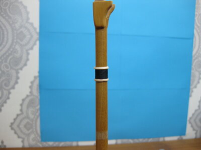

First try with Fimo clay (polymer clay)
I wrapped it aroud the mast right away out of the oven and let it cool down.
Then I shaped it a little and put it in place (dry fit)
it only needs a color, but that is for later concern.
The rope is 0,4 mm, the thickness of the hoop is 1 mm
Maybe when it is in place I sand a little down of it. (tape the rope for dust)
It's difficult because the mast is already in place.

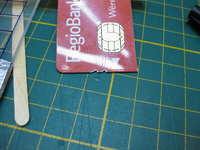

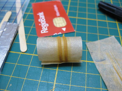

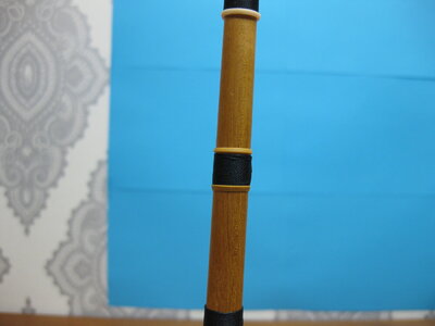

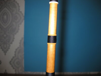

I wasn't satisfy about the result with the polymer clay. So I started to experiment with different kind of things. And then I got this idea.
I have a different kind of polymer clay that I bought by a store named Action. It is more soft than Fimo. And more colours.
I took a piece of a credit card that I cut in shape and I scrape the clay on baking paper. Till I get the clay in the form I want. Then bake and curl it. This is the result.
Maybe only a little paint to finish it.
This way I will do it. Thanks for al the advice and hints. Sometimes a suggestion is the only thing you need to get the result.

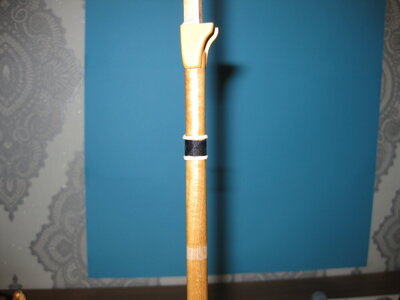

Thank you Hubac, one mast is ready at this time.
Here is the end result post #16

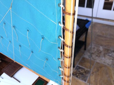

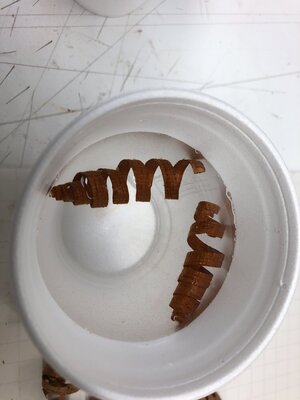

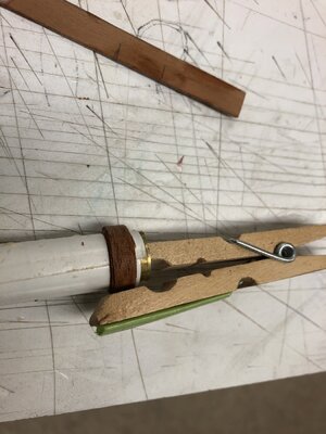

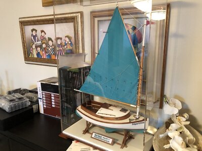

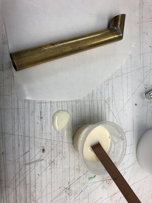

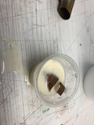

This is a method I used to make the mast hoops for my Catboat.

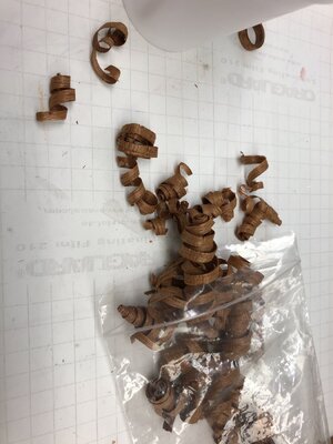

I created some mahogany shavings, soak them in water for one hour, take a piece of brass of your needed diameter, wrap a few turns with wax paper, take out the shavings and deep then in glue, carefully (the savings are very brittle) wrap them a few turns over the tube and hold in place for another hour.
After dry, pull them out from the tube, you could take a piece of sand paper, lay out on a flat surface and sand it to shape.
This is my old ways method since I don’t have a lathe and don’t know how to use one neither.
Don’t know if it will work for the smaller version you need.
