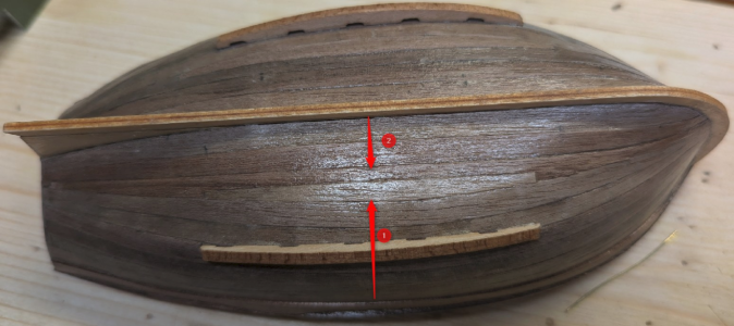

Hi Thomas,
oh god your planking looks so wonderfull. I hope after building 10 more boats I'm able to make it also so perfect.
It seams you had another type of wood for your planking.
I tried it, like Pepite explained it above with an additional rule that the planks shouldn't be tapered to less than half its original width.
I started with two planks untapered from the top (what is bottom in the picture) - from your fotos I think you didn't do it like that?
But I came to a point where it was not working any more to mark the overlapping with at the same time not tapering the plant to less than half its width (1). At that point I started from the keel. Were the two plankings met I had to add some special planking (can it be called a special drop plank?).
An advice: Be really carefull with the plank bender. Do not put to much pressure (better none at all) when glueing the wet planks. I was able the create a lot of bumps that were very hard to correct afterwards.
...and I used an acrylish varnish.
Even if it by far is not looking so good as your boat, it is really funny to build it.
