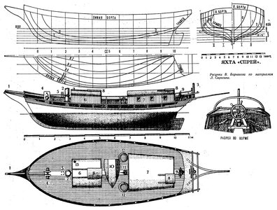

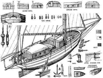

Very nice model! I had planned years ago to build a model of the Spray but only got as far as drawing plans in 1:32 scale (first picture below). This was drawn from the lines in Captain Slocum's book "Sailing Alone Around the World." There have been a few replicas of the Spray, including one commissioned by Pete Culler in 1929. The second picture is a photo of that vessel from Culler's book "Skiffs and Schooners," which has a chapter describing its construction. There is one probable, minor error on your model. Slocum's Spray would not have had the double jibs as on the model. The confusion seems to have occurred because of changes to the rig made during his voyage. The third picture is the figure from Slocum's book showing the rig at the start of the voyage (solid lines) and the modified rig (dotted lines). Both rigs had double headsails but neither had the tacks or luffs of the two sails as close as those on the model. Fair winds!
