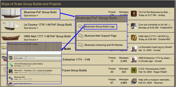

-here you find the complete —> translated manual <—made by several member and collected by Johan.
-take you time to have a look in the —> Bluenose Main Support UPage <—. Many issues were discussed there.
