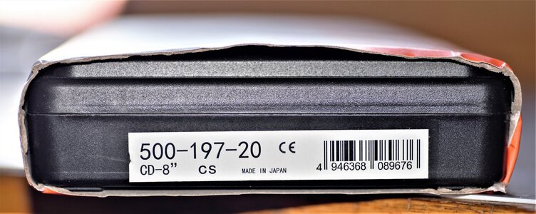

The packaging tells me it is Mitutoyo, and the side panel label matches the product number I ordered, and of cause - Made in Japan! Yay!

Greetings all! Hope you have a relaxing weekend and spend some time with your hobby. Mine was sweetened with UPS delivery and the real-deal Mitutoyo caliper made to its new home. I got pretty much the same model as the counterfeit with the exception of the length. Technically, I don't see the use of 200mm so 150mm it is.
The graphics on the packaging is different, though it is the same Mitutoyo color.
It was sealed in a plastic bag with 'ferobrite' paper.
All accompanying paperwork was intact and didn't staple together. The package contained a single SR44 battery, NOT preinstalled.
Most important, the serial number on Inspection Certificate matches the serial number on the caliper.
