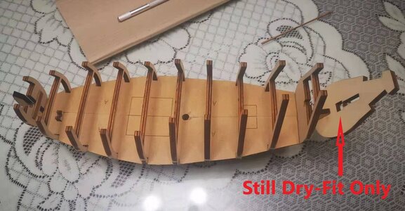

Now we can glue all bulkheads (EXCEPT BULKHEAD #11 - the rearmost one that forms the stern) to the keel and fit the deck.
And that is what our assembly looks like at this point. Please please note that Bulkhead #11 is still dry-fit only at this stage.
In my case, I have also glued pieces of scrap plywood into the corners (between the decks and the hull) just for extra stiffness and strength. When doing this, just make sure that you leave the hole for the main mast open (marked with the red line).
