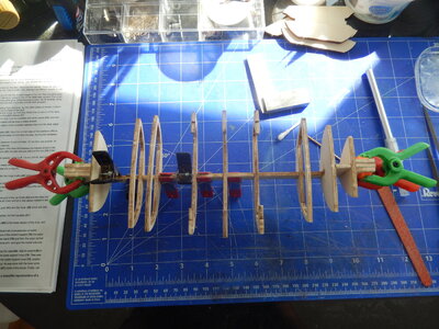

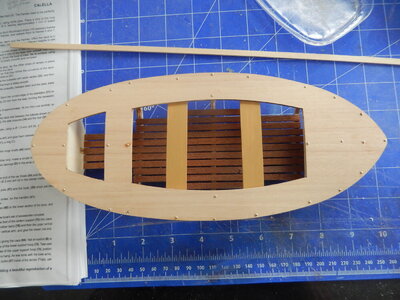

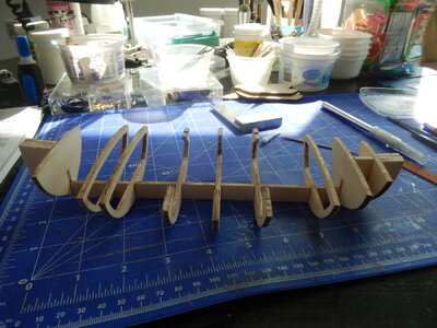

The build has been straight forward so far. Frames glued to false keel, floor planks installed, thwarts glued in, first decking added. I used 2 coats of a clear finish on the floorboards instead of painting them. I was planning to do the same on the thwarts but after spilling some thin CA on one of the thwarts I decided to paint them (the CA discolored the thwart as it was pulled into the grain) with some ochre paint I had in my collection.

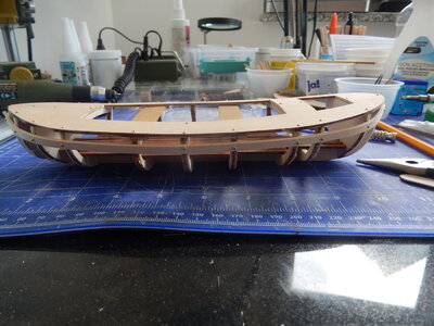

The first planking strakes on each side have been installed and work has begun on the next ones. The bend in the strakes is gentle in the middle portion of the hull but pretty severe at each end. I’ve soaked several of the strakes and then clamped them to the edge of the round table that is my work surface; this creates the major part of the hull curve. Then I use an older hair curler to create the more severe bends at the bow and stern. As the hull flattens out as the bottom is reached, enough stakes have been left unbent for now; they will be bent/twisted as needed to fit.
The strakes are glued on and held in place with nails. I have a 0.5 mm drill bit with a large diameter shaft for my Proxxon drill but that size is just a hair too small for the nails. 0.6 mm works better but the drill chuck won’t hold them. So I initially drill the nail holes with the Proxxon and 0.5 mm bit; then I use the spring operated twist drill and 0.6 mm bit to enlarge them just enough so the nails can be pushed in without difficulty. When I bought that twist drill I wasn’t sure if I’d have a need for it; it just seemed like a nice tool to have in my tool box. Is has proven itself so I’m glad I purchased it.
