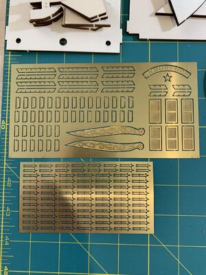

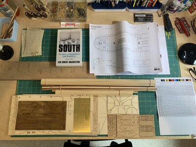

Hey shipmates! I started my second build, the HMS Endurance by OcCre, after completing the Albatros. I learned so much from SoS the first go around, I'm excited about this ship and adding in some of the detail I learned about by posting and following other awesome builds. It was a couple of months after I finished the Albatros that I started the Endurance, so to slow-roll into my new build, I started with the boats just to get going again. Also, the metal boat supplied by OcCre for the Albatros was very uninspiring (I understand as the Albatros is a beginner build), so I really wanted to build some nice boats. I've finished the boats and am ready to move on to the ship. Summer is not the best ship-building time, as we end up spending a lot more time outside, but I've gotten some done and am looking forward to working on it more in the fall. Here are some pictures of the Endeavor unpacked and my progress with the boats. The builders on this forum were extremely helpful with my first build, so please offer pointers and recommendations when you see me about to screw something up. Thanks shipmates! IMG_0304 (1).jpegIMG_0305.jpegIMG_0310.jpegIMG_0311.jpegIMG_0338.jpeg
