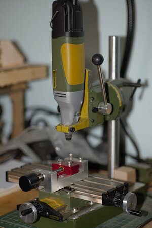

  • The last one is the Proxxon EBS (I believe). It didn't fit in the above image simply because it is permanently installed in the drill press attachment. I think it is the most powerful\ and versatile tool in my collection. It is built to last with precision in mind. It comes using the standard Proxxon collet system and variable speed control. If you read to this point, you already know that I am not a big fan of collet systems in rotary tools. It is Ok when you have all of your drill bits on the standard shaft. But what happened if you don't? I have many sizes of standard drill bits and would like to use them. Unfortunately, I couldn't add a chuck to this one, it doesn't design for the chuck replacement. Alternatively, I bought a flexible shaft and headpiece, the handpiece does come with the chuck, but... I couldn't mount the tool without causing too much noise and vibration and the flexible shaft got in my way so it is still in the closet. :p Since I didn't have a miniature drill press, I decided to convert this rotary tool into a drill press. This is still my best setup and this toll is awesome for the purpose it is suited now. Pairing with the coordinate table it makes a device of my choice still. I am using it daily for drilling, and with a special setup, I use it as the mini-lathe to fabricate trucks for gun carriages

I used no battery powered drills. I got power on my workspace. For the heavy work I use also a Dremel (300) Old one, once bought back in 2005 and never used till I started modelbuilding in 2019. Used a lot since then. It came with a flex.shaft and bought a drill stand for it incl. an attachment to make a handheld router of your dremel. Strong but to strong for woodcarving and also to heavy to work to long with it.
I also got a small drill with high speed, it was a present that came with the Prins Willem. Old but perfect to drill straight holes. Seems to be designed for drilling electrical circuit boards. Makes a lot of noise because of the high speed.
For woodcarving and sometimes for drilling holes by hand, I use a electric nail sander, used by the lady's to sand acrylic nails. But extremly perfect to shape ornaments of ships. The drill is light in the hand and you can hold it close to the mill. Variable speed. Not very strong but for shaping small parts perfect.
Got a lot of drills, endmills and other stuff to use with it. An extra handset for 3,175 shafts (standard 2,35 mm)
Next to the lightweight of the handpiece it is also very silent. Important when you carve. Carving takes hours and the dremel makes your hands shaking and ears deaf. This one not.
On the last picture are HSS drills, these come with 10 in a tube. from 0,3 to 2,0 mm in steps of 0,05 mm. Price of a tube about 1 to 3 euro. But they are long lasting and don't break easy.
