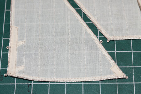

The sails (only the reef points are missing).
