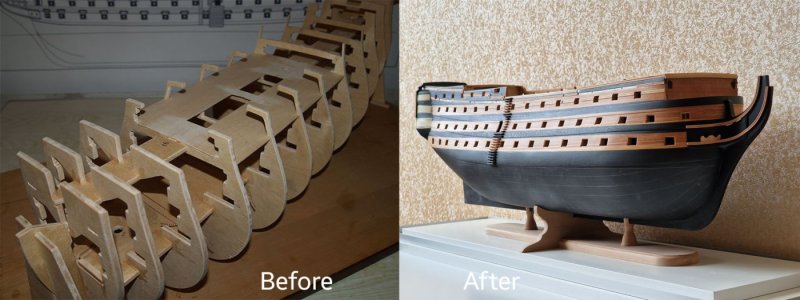

As you can see from the title, it’s HMS Victory. I created the framework of the model using plans from a Mantua kit. I didn’t buy the kit itself. I printed the plans in A0 format and built the frame (the skeleton) based on them. That was the end of my work with the Mantua kit. All further work was based on John McKay’s anatomy of the ship. In this journal, I want to take you through the whole process, from the kit plans to the anatomical upgrade.

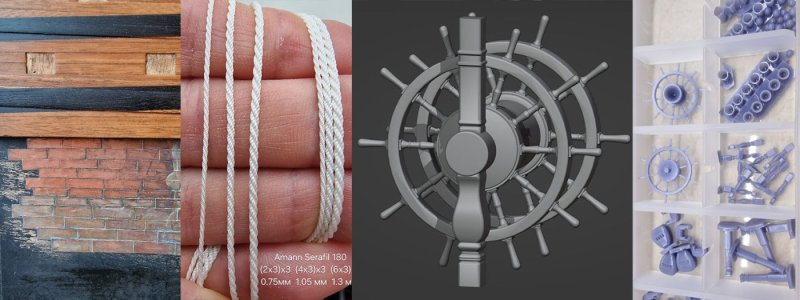

I would also like to share my experiments: Working with blueprints. Aging and painting wood. Aging copper. Making and painting ropes and rigging. 3D modeling and integrating 3D printing into wooden shipbuilding. And much more. It will be fun, and I hope it will be informative for you. I’m sure I will learn a lot from you as well. Thanks in advance for that!
