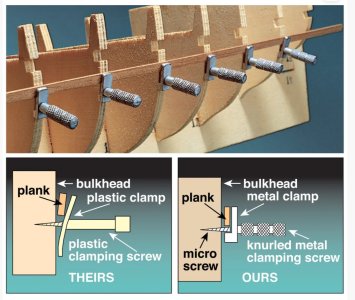

These might be of help as well https://micromark.com/products/micro-mark-10-piece-planking-clamp-set?keyword=planking

Have used them but care needs to be taken that you don't split the bulkheads/frames (I pre-drilled with a .8 mm bit when I used these on the Gunboat Philadelphia (which is what the instructions for that kit suggested using). Also, get the ones with the metal heads if you are going to use them; the heads of the plastic-headed ones can break off easily when pressing them in to wood.Has anyone used 'push pins'; placed into the frame member to hold the plank in place?
I just use a small punch and small hammer and knock the pins in further before sanding rather than pulling them out. Given all models have a 2nd layer of planking you never see the pins again. Regarding planking practice over a number of models will help with your technique ... keep plugging away.Hi, I am new to this wonderful hobby and am building my first model, Polaris by OcCre, I have received several helpful emails from members but a thought has occurred while sanding the first planking layer. The OcCre videos and other vids show the pins in place and consequently you have to file them flat to get a flat surface for the next layer of planks.
My question is when I was carrying out the first planking I inserted the nails as shown on the plans, which is a lot of nails, but could I nail the pins in to say three quarter of their length rather than the whole way and when the glue has dried remove the nails. When the nails are hammered in flat it is difficult to remove them without damaging the planks.
