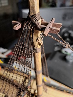

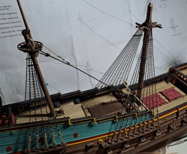

Update of last week. As I was working on the shrouds of the main mast I can tell that both are now ready. All the way up to the futtock stave.
And the overview.

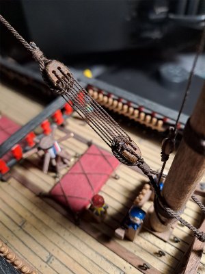

After the ratlines I placed the main stay. The detail on the top. With already 2 blocks on each side hanging on the stay.
And a detail tied up on the bottom with the big "10mm" blocks.
