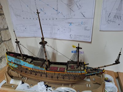

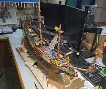

The update for this week.
I worked on the new shipyard and I hope to finish it next week so I can start modeling from the new yard.
Now I use my work desk as the yard every evening. With the change on damage when moving it.

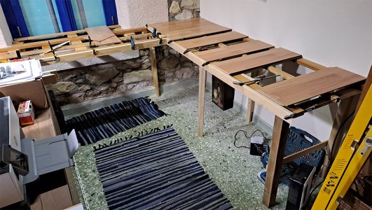

Current status of the shipyard.
The worktop is made of laminate (left over) and everything is made of used and/or residual wood.

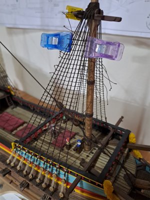

This week I worked on starboard side on the Fore Shrouds with the ratlines.
The current status is:
I see that I have to lower the last top ratline a little. And also the Futtock stave. (Miner detail ;) )

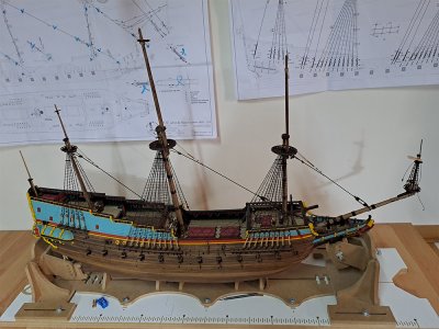

The last image is an overview of the Batavia on the new workbench (not yet fixed) with a blank background.
Next week is finishing the ratlines and start with the Fore stay. Maybe start with the Crowsfeet.

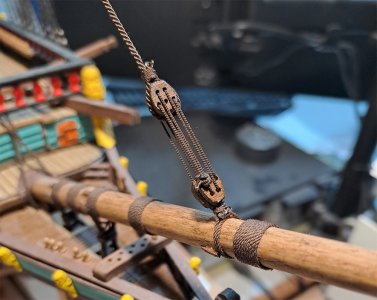

The connection of the Fore stay and the bowsprit
As can be seen, only four of the five holes in the block have been used.
The fifth, in the middle, will later be used for the rope that will tension the backstay, which will then be routed to the lower right for tying.
There are still some light glue residues visible on the shrouds, the Futtock stave, and the connection to the bowsprit.
These will be treated with a drop of "oak brown" paint.

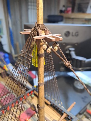

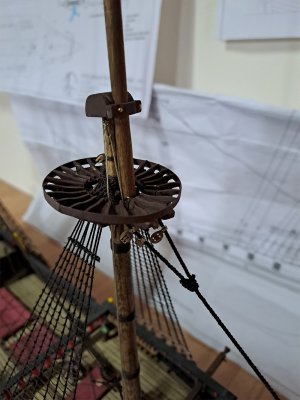

The next step was to install the "Mast top," the "Fore topmast," and the corresponding "wind rope" (do not know if this is the correct word) to the deck.
NOTE: The wind rope should run BETWEEN the cross tree and then through the bottom of the Fore topmast. Not around it. This is an easy mistake and usually difficult to correct.

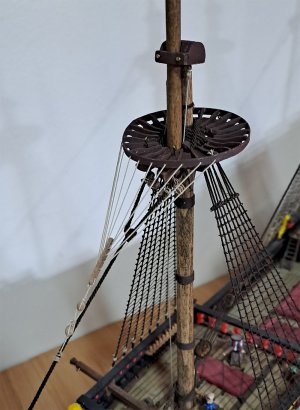

Because things were going well this week, I had some time on Friday and Saturday to also place the "Crowsfeet" on the Fore mast/stay.
Which still needs to be finished and the short remnants trimmed away.
Finally, another overview photo of the current situation. With part of the "backstay" already attached to the right of the spritmast.
