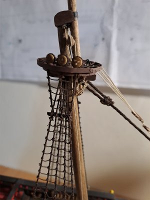

Next up were the six shrouds at the futtock staves. According to the drawing, they were supposed to have "double legs."
After the "dry" installation, it was quite a crowded affair up there. (scale 1:72)
So I abandoned that and switched to a single attachment over the futtock stave. Five of the six futtock shrouds are now attached.
The first one is from the mizzen mast.
The loose ropes under the deadeyes of the mainmast.
And another shroud on the foremast.

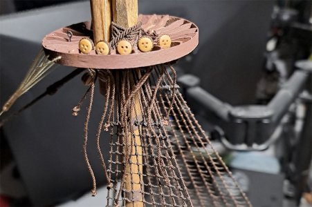

The last futtock shroud rigging on the main mast was due. Number 6 of 6.
This one is also finished.
That completes the "first floor" with the standing rigging. I think.
Here's an overview photo of the moment.

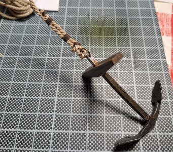

My measurements came out to 47mm for the stock and therefore also 47mm from the top of the stock to the bottom of the anchor.
Start with the following parts.
The metal of the anchor has already been worked and treated once.
More work will be done on it. It looks very neat and tidy this way. ;)
After some cutting, the parts were glued together. Not quite finished yet.
Yes, well spotted.
The "stock" is on the wrong side. A common mistake for beginners.
So we take it apart again. (Pulled the shaft out of the stock, gave it a quarter turn, and put it back in.)
And this is the result.
We treated the metal a bit more and also gave the stocks the necessary treatments with sandpaper, knives, and paint.
Then we started on the anchor cable, using a "cable hitch" in the ring. (See page in the book.)
With final result of the connection.

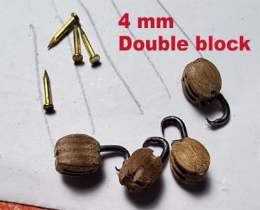

And the four required double blocks with hooks will be fitted.
These will go under the cathead beams and the penter beams. (If those are the correct terms.)
