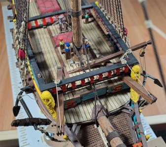

The last futtock shroud rigging on the main mast was due. Number 6 of 6.
This one is also finished.
That completes the "first floor" with the standing rigging. I think.
Here's an overview photo of the moment.

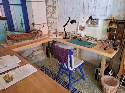

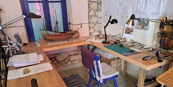

You've created a wonderful workspace, Clemens. It's such a joy to work there.So, another week has passed. Time flies.
But...
We're not sitting still.
The new shipyard is finished and in use, except for two items.
Still:
- a noticeboard in the window frame
- an office chair with adjustable height
It's a U-shaped layout with, from left to right:
- a 1.60m chest of drawers, 50cm deep, and 80cm high, with 6 drawers
- a 2.10m worktop, 50cm deep, and 70cm deep in front of the window
- a worktop on the right side, 1.40m and 60cm deep
- the worktops are 77cm high
The drawer cabinet holds the construction drawings and a microscope with a screen.
This is for those very special and incredibly small parts that can no longer be seen accurately with regular glasses, such as the binding of very small blocks.
Next to it, on the long workbench, is a magnifying lamp and the model I'm working on.
No other parts are placed on that section, so the model can always rotate freely without obstructions.
The right leg is entirely my "workspace." I only use hand tools, and the Dremel is the only electric tool.
Of course, there's good "cool white" lighting.
A view from a different angle.
The working drawings hang on an old metal rail with colored magnets.
The drawings will change as the work changes.
We're ready to go again.
Everything we don't need right away is in the drawers. Standard tools like pliers, clamps, tweezers, scissors, etc. are, of course, always present on the workbench.

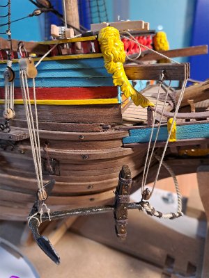

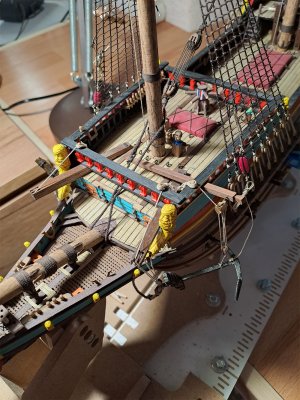

I was working on the anchors and the associated suspension.
This page has nothing to do with the anchors, but it just happens to be the page next to the anchors.

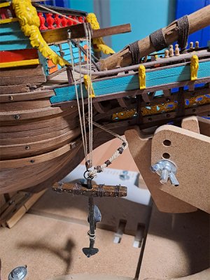

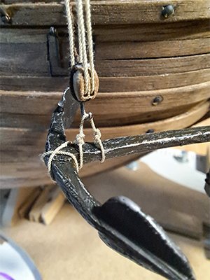

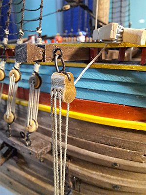

First, the crane beam is fitted with a tackle. And then the penter beam.
View attachment 569802 View attachment 569803
The penter beam, I read somewhere, is only used during the lowering and raising of the anchor and is then stowed away in the hold.
So normally, there's probably only one penter beam, not two like we put on our Batavia models. It just looks nice.

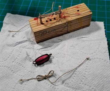

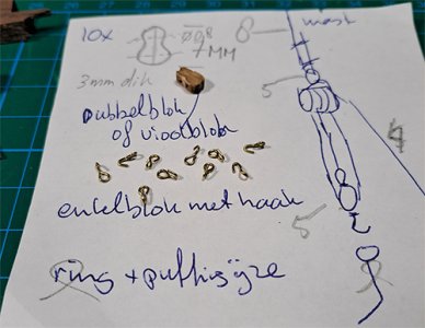

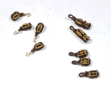

Also, because these are removed every time, I opted to be able to remove the tackle by hanging it from the penter beam with a kind of "three-block violin" with a hook. This makes it easy to store.
Probably not historically accurate, but hey... who cares?

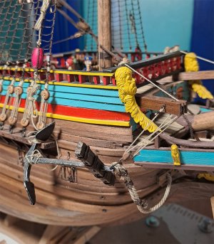

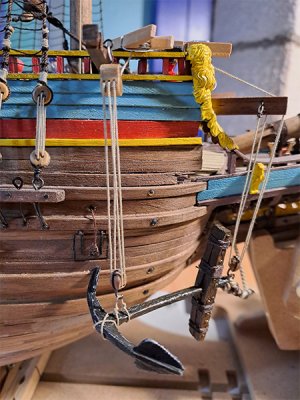

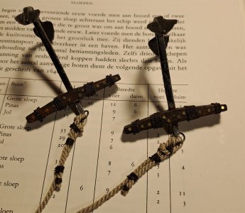

Here are three detailed photos.
View attachment 569807 View attachment 569808 View attachment 569809

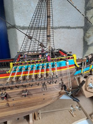

Finally, a complete overview.
Since I couldn't find much information about how to tie the tackles, I opted for the attached photo in the building instructions.
A photo showing the ropes tied to the railing. (Photo from the Zeven Provinciën, Dutch vessel)
I'm going to leave the anchors as they are now.
So not in the "storage" position. Otherwise, the penter beam would be redundant in this situation.
Next week I'll be working on the two rope bundles for the tackle attachment pins, the start of the "anchor buoy" with the ropes, and probably also on the port side anchor.

Thanks Stephan,The fiddleblock is the topblock and the doubleblock on the hook.
Here you can zoom in to discover a lot of details.![]()
