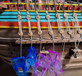

I had some time to start with the sets of Fore Shrouds. For the Batavia that are 9 sets. The last one has a shroud on portside and starboard.
After fixing the length I start fixing the deadeyes. So they are in line with the green planks on the side after tensioning.
To make sure they do not turn they are fixed with 2 small drops of glue on the back.
Next week I hope to fix all deadeyes and start to tension all the shrouds and ready for the ratlines.

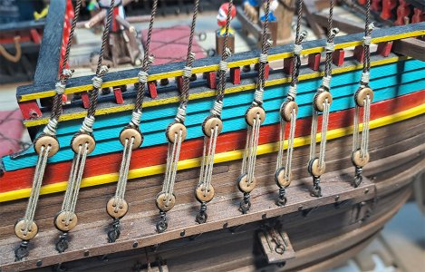

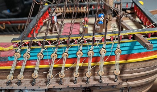

Last week all the deadeyes are fixed in place on the shrouds. All 18 on the fore mast.
After that I fixed the lanyards just in place but with almost no tension. But in the right direction.
After that I start tensioning the lanyards. 2 Starboard, 2 portside, etc...
I done 4 on each side so I do not bend the mast to one side. I did 4 on each side Friday.
Yesterday I cut the excess length of the ropes. Oops.... on the 3de lanyard I cut a piece of the shroud. Sharp scissors. :eek:
Not the long part to the top, but the short end. It was already tied up.
So next week I have to fix the mistake and hope to tension all other lanyards.
See you next week.

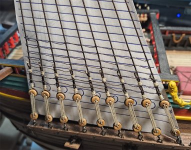

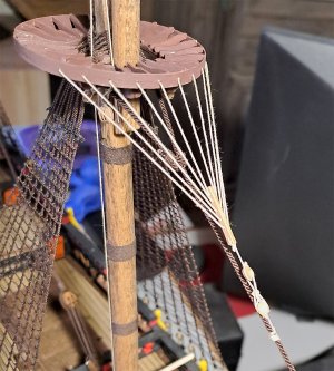

Last week, I continued working on the new yard layout (work desk) and the ratlines of the port side Foremast.
This is now complete, except for finishing the futtock stave and shortening the excess length of the ratlines.
Next week we'll continue with the new workbench, finishing the futtock stave on the port side and then starting the ratlines on the starboard side.
