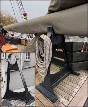

The middle support for the jib boom:

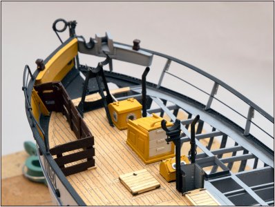

With the bracket that can be opened when the jib boom is retrieved. Many corner profiles that are riveted together.

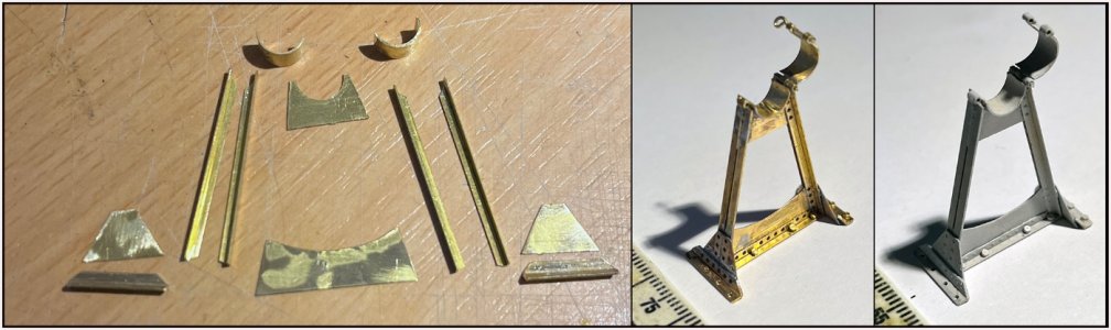

The first 12 parts to solder together:
It was not easy to solder everything. Once you have a few pieces together, some of them come loose when you attach the next part. Ultimately a support. The details can still just be seen in the primer.

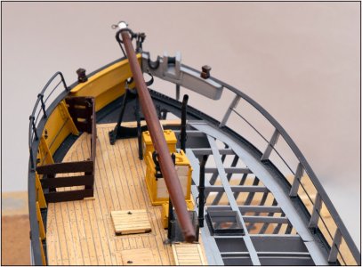

On deck in place:
With an oblique support in the length. The extension tackle is secured to this when the jib boom is moved outside.

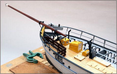

I had to wait for some brass material and then sanded the jib boom into shape:
Equipped with 'Brasil Brown'. Fits nicely over the supports.

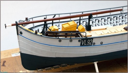

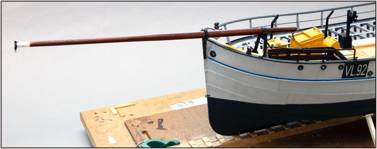

With the jib boom deployed:
The bracket is now closed and secured with a pin.
Then it immediately becomes a completely different sight.
I won't be opening and closing the bracket very often anymore. That is a very fragile construction with pieces of tube of 1 mm and internal 0.6 mm.

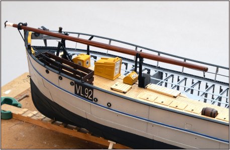

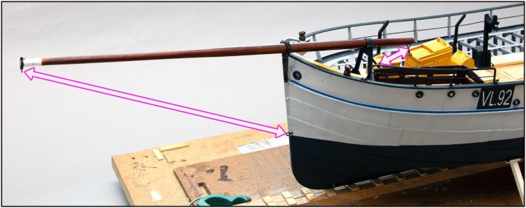

In the full scale vessel, do the clamps grip tightly enough to keep the boom in place, or does tension have to be maintained on the expansion tackle?
Thanks, Russ. The clamp gives tension around the boom but not enough for some sliding. Therefor a water stay in the front and the tackel at the end:
