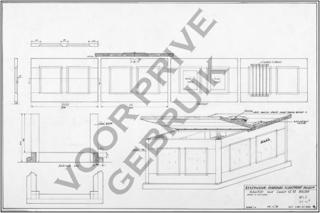

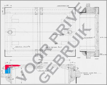

To determine the position of the other crib, I actually had to first make the hatch for the net hold. But that hatch consists of two interlocking parts. Here's a nice drawing from the Amsterdam archives:
Bottom left: the frame in blue and the hatch fits around in red.
Like every new part, it's a challenge to recreate this to scale. It's also a matter of 'simplification'.

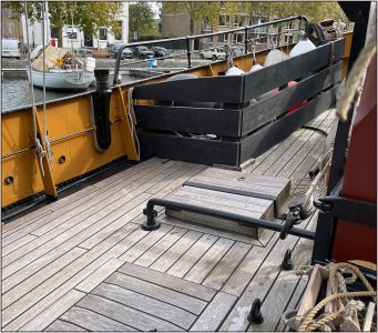

So first, just a regular hatch. The example just behind the breeds crib:

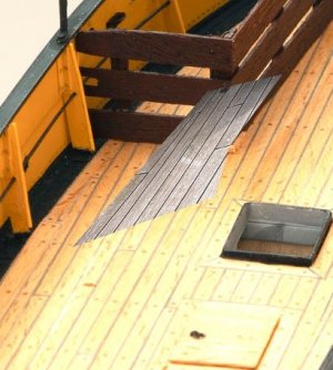

The hardwood frame around the deck opening. And at the bottom of the hatch, the frame that fits around the opening.
It fits again:
But... the hatch has become proportionally much too large. Back to the drawing board... ;)

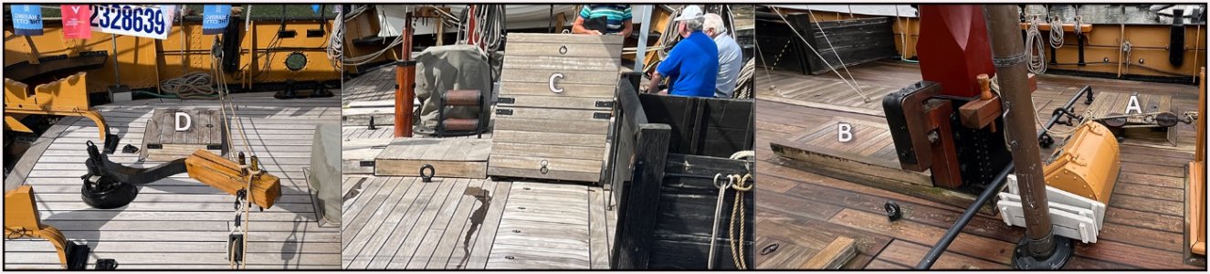

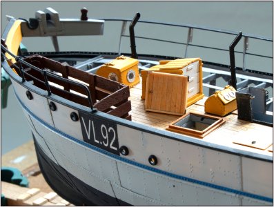

Continued with the remaining hatches:
A: the test hatch from the previous post.
B: the sealing of the cove of the 'kossing';
C: the double hatch on the net hold;
D: the hatch above the aft storage area.
The double net hatch is used on the Balder to close off the stairs to the large space in the former barrel holds.

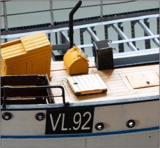

First, hatch 'D' was made to further develop the skills:
The cover wood for the hatches is lighter in color than the wood on the deck. The specifications and drawings clearly state 'pine wood'.
Then 'B' and 'C':
The net hatch consists of two parts. A small ridge on the inside near the closing strip prevents a half hatch from sliding open. The kossing hatch also has such a ridge. It is also more or less a half hatch because it has no closing strip on the mast side.
It doesn't matter which of the two halves is removed or replaced first:
The hatch by the water pump has a lip that fits under the other part. The kossing hatch is made slightly differently. It has two longitudinal strips on top, with cross planks between them.

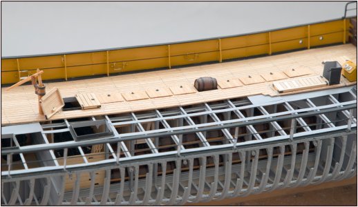

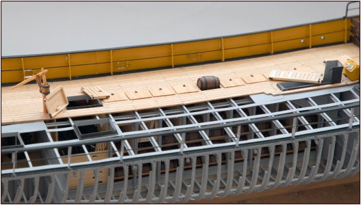

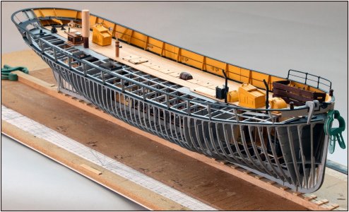

Here's an overview till now:

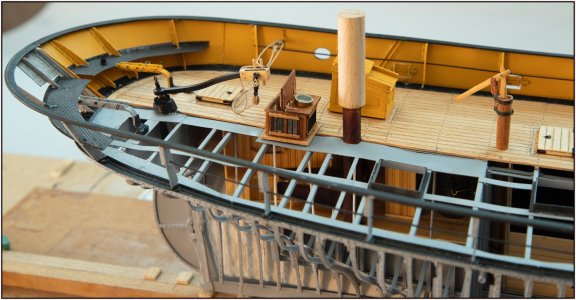

Two more openings to close: the entrance to the rear cabin and the skylight above.
Then 'B' and 'C':

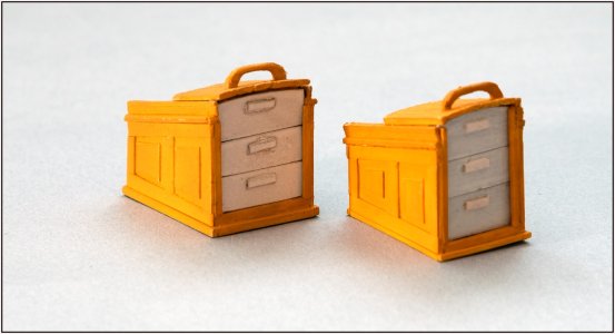

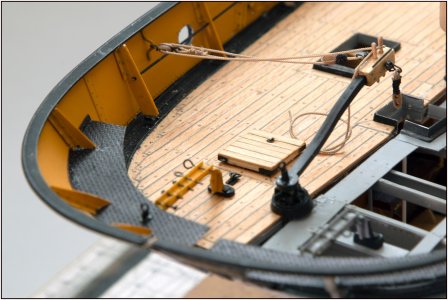

Based on the model for the forecastle, a second one was made:
It's slightly smaller. Only the captain and helmsman need to enter. Now both with a handle.

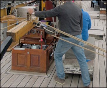

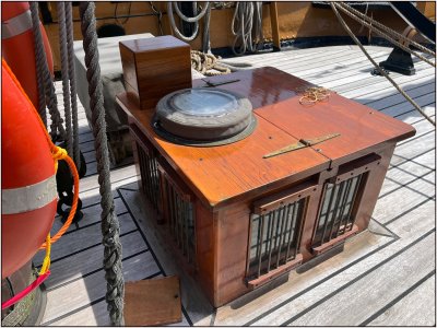

This is how it is on the Balder:
With the compass at the front and two beautiful copper hinges.
The bars protecting the windows are set in fairly large bars.
However, it was redesigned to be multifunctional:
The rear section of the hood can be folded up. All the necessary equipment is installed underneath. The throttle for the engine is on the side.
There was a drawing in the Amsterdam archives:
That's always helpful for dimensional control.

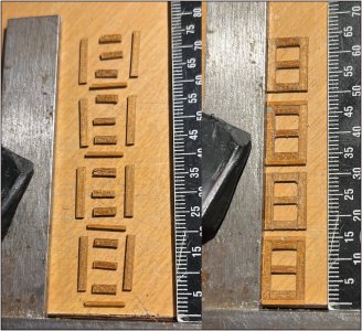

All the parts were cut to size:
And glued together panel by panel, including the corner posts in two of them.

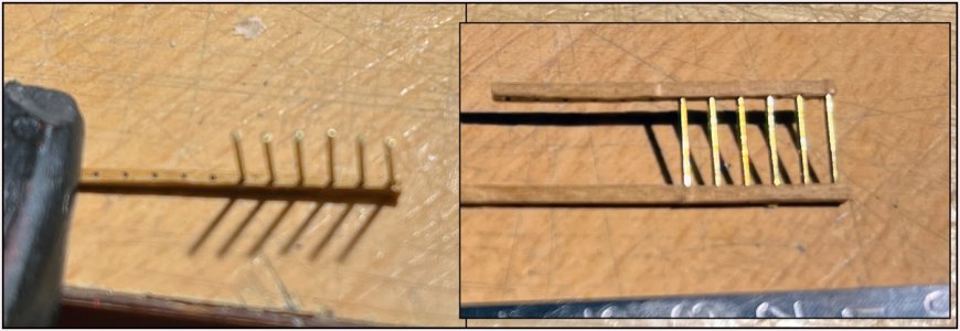

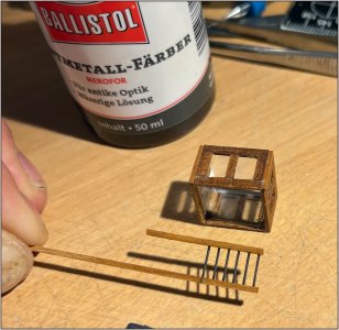

For the bars, I drilled 0.5 mm holes every 2 mm in 1x1 mm strips. 0.5 mm brass rod fit into these.
And I managed to fit the 6 bars into the top holes four times per frame. Next time I will make them sharp .........;)
Then I put everything in the Ballistol to burnish:
Wood and all. No problems.

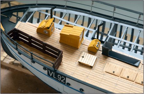

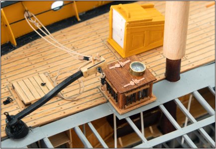

This is what the aft deck looks like:
With working hinges made of brass foil and a 6 mm compass in a brass frame and cover glass. (No: the compass is not functional ...........;))
With the hatch open, without any equipment. Just to air it out.

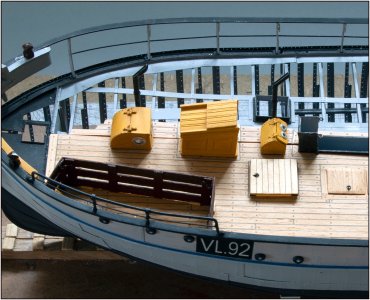

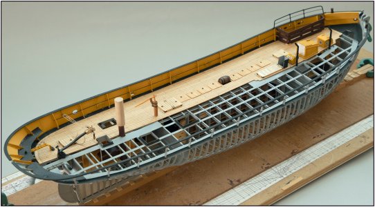

Now all the openings have their closures:
Now I'll start on the metalwork.
