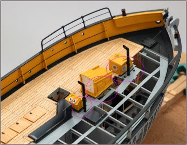

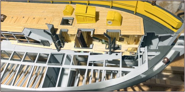

I wasn't satisfied with how the three covers had there 'fit' on the starboard deck:
I'd glued some small planks onto the forward one, but that's just sloppy. The other two float above the plating.

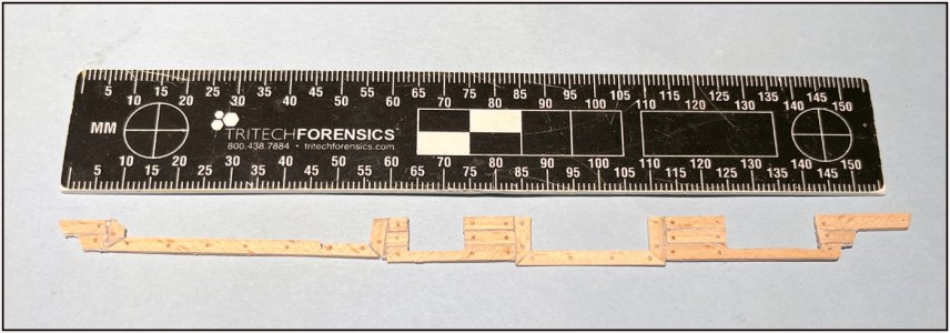

So I made a piece of deck:
Following the pattern of the port section. It's quite delicate... so be careful.
Always check on the starboard section:
It all fits just past both funnels.
In place:
Also coated with the layers of linseed oil. A cover will also be placed on the long opening of the mast 'kossing'. This will be included along with the deck parts.

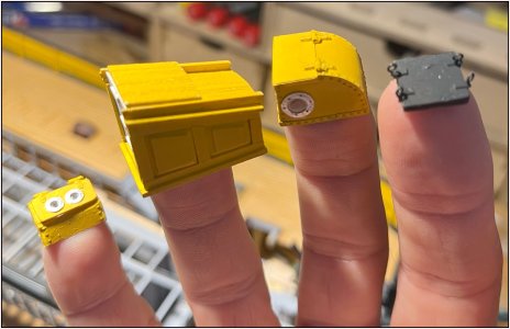

In Amsterdam, there was also amazement at the size of everything.
Unless someone says I have very large fingers ......... ;). Not completely happy with the painting of the last one. But in 'normal view' on the deck .....

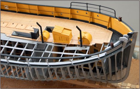

In place:

This is a smart solution and makes the deck and its deck houses and hatches visually very appealing.
The only drawback I see is that the deck furnishings cannot be permanently installed, but hey, een kniesoor die daar op let. (Translated: "A brooder who pays attention to that".)
I wouldn't say "large fingers", instead I would use "small scale", but than again, some people built in 1:200.
At least this scale gives the option for some nice detailing, an option you make full use of.
Thanks, Johan. The 3 covers has now also the function to clamp both parts together. And with some friction they can also stay on deck on only the port side. I’ll show that later.

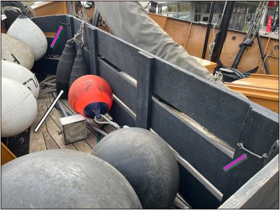

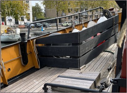

I had already made the breels railing on the bulwark. Now it's time for the breels crib.
It consists of three parts that are held in place on the deck with small cleats. There are two U-profiles on the bulwark metal to holds the ends in place of the 2 side parts.
On the inside, at the corners, are two simple hooks with eyes (blue arrows). At the white arrow, are two original wooden breels.

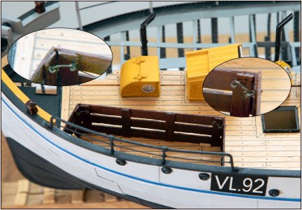

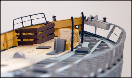

I still had some dark wood in my stash that matched the 0,8 mm thickness:
I coated it with Schmincke Brasil-Brown so it resembles the old 'Carboleum', which is no longer allowed to be used.
Also two hooks on the corners. From my stash of 0.4mm wire, eyes bent around a 0.7mm nail:
But then you also have to get the hook into the eyes after placing the parts.

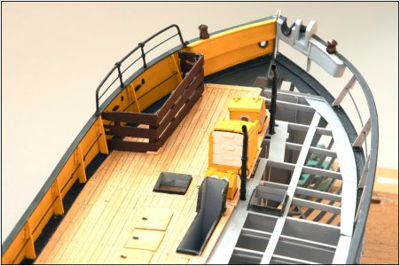

From a slightly different perspective:
The foredeck is starting to fill up nicely.
