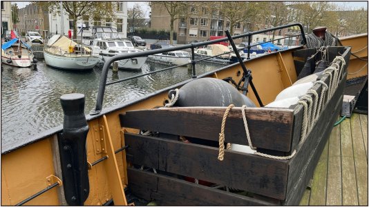

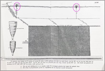

The next part at the front is the rack near the 'kribbe'/crib where the breels are stored:
The breels are the wooden ones, like floats on the line of your fishing rod, that keep the nets afloat at the right distance from each other.
Here's a photo for clarification:
The explanatory text: "The entire fleet consists of 70 nets. The first 35 nets are each supported by a full breel; from the 36th net to the end, halfway down each net, another half breel is used."
When hauling in the fleet, quite a few breels have to be hauled in. These are thrown into the crib from a distance. If the crib fills up, you don't want them falling out of the bulwark at the back. Hence the piece of fencing to prevent this and also to allow the breels to be stacked higher.

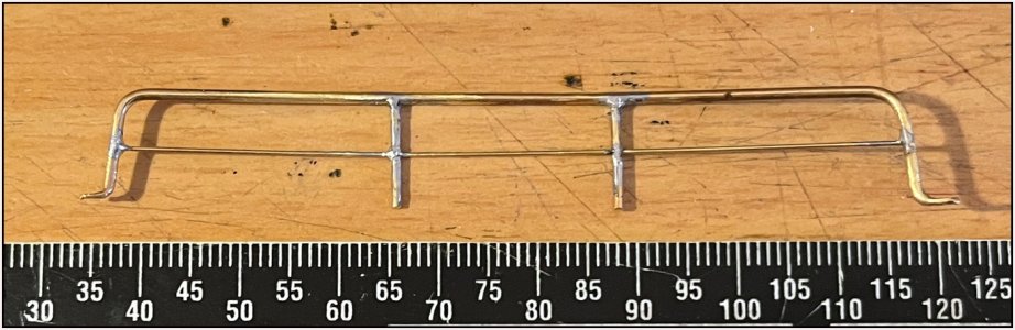

First, I started working on getting the hang of soldering again:
There are still quite a few brass parts to be made.

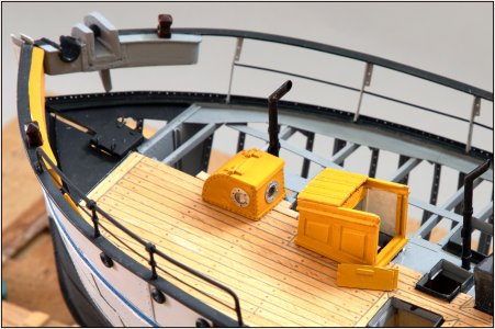

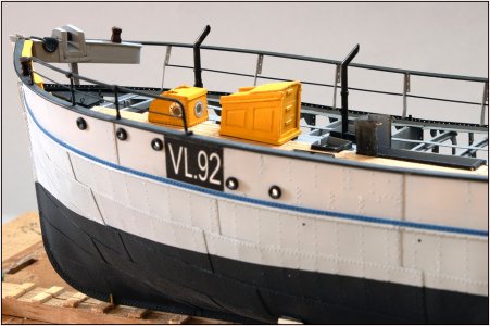

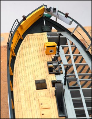

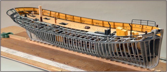

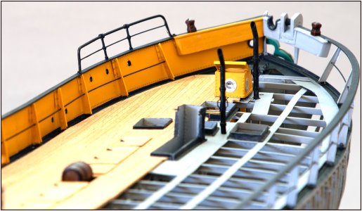

With some small thickenings at some joints (see the example), the whole thing was painted black and installed:

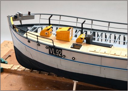

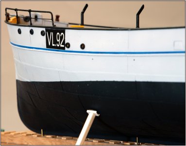

At the moment, it's a dominant feature, and from certain angles, it looks slanted.
But it follows the curve and cant of the hull:
Which further enhances the lines of the bow.

Thanks, Paul. With some patience and correct temperature the outcome was acceptable. After some filing and sanding ready to paint.

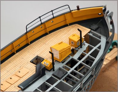

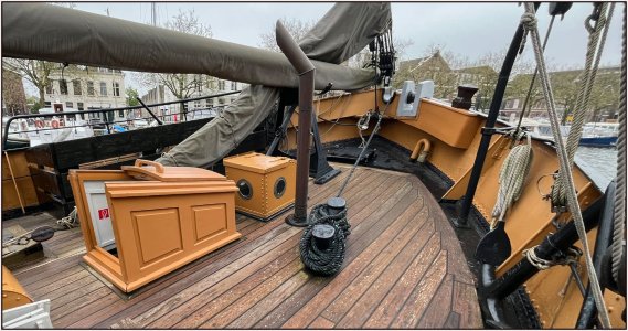

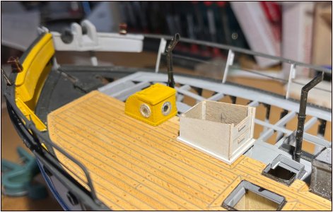

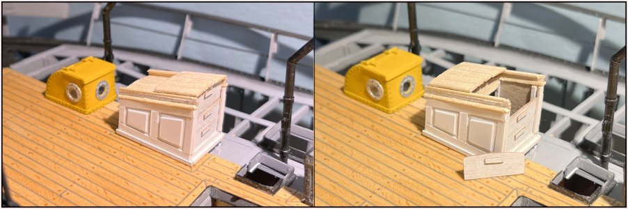

Started building the access to the forecastle.
That's made entirely of wood, so I also used wood for the model.

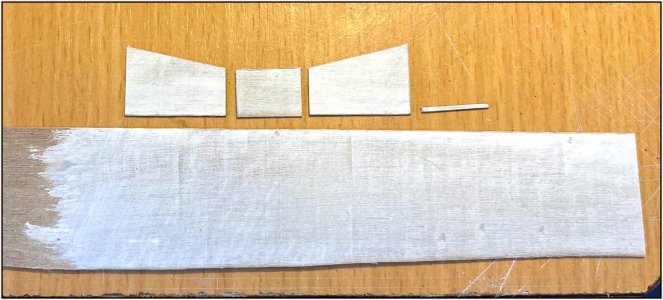

As a test to see if what I have in mind works, I applied two coats of primer to a 0.4 mm strip of plywood, sanded it, and cut the inner side walls:
I saved the small leftovers when I saw the deck planks and uses then to make some corner posts, the floor profile, and guide rails:
The entrance panels are removable:
Now to see if I can make the outer walls with the panels with angled edges.
After some experimenting, it finally became a combination of the thin plywood and Evergreen. With 'fielded panels':
It needed a thin coat of primer to see if the sliding hatch still works and if the three planks can be removed and inserted. The roof and hatch are made with beaded boards (kraaldelen) instead of flat planks.
Everything went according to plan, and everything was airbrushed in the Ochre color:
Completely wind and watertight.
The rear also has its own panel:
Making the guide rails was a bit of a puzzle, but they also slide nicely into the grooves of the hatch. And with this light the beaded boards are also nice in view.
Opened and with planks removed:
A proper access to the forecastle.

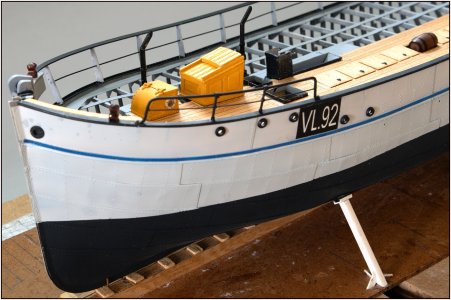

I visited the ship model fair in Amsterdam today and was able to “inspect” Balder. And I tried to catch up, but you had disappeared to some briefing. Oh well.
In real life the model is even more spectacular. Superb detail.
I am so sorry that I have missed you, Marco. But how nice that you took this photo! In this perspective it’s a huge model ….look at the guy behind it …...:)
A little later, I was told by Sjors you were looking for me. I first attended a lecture about the collection in the museum's depot. Following that, there was a lecture on "Fishing History in Ship Models." As the builder of the Balder, I couldn't miss that. I got a private lecture, as I was the only listener..:confused:. It was a shame for the lady giving the lecture. But she had already sought me out before the lecture, knowing that I was building the Balder and she had been connected to the museum in Vlaardingen, to which the Balder is related. So it turned into a very lively interactive lecture.

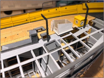

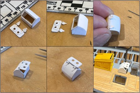

The closure of the 4th opening, seen from the bow:

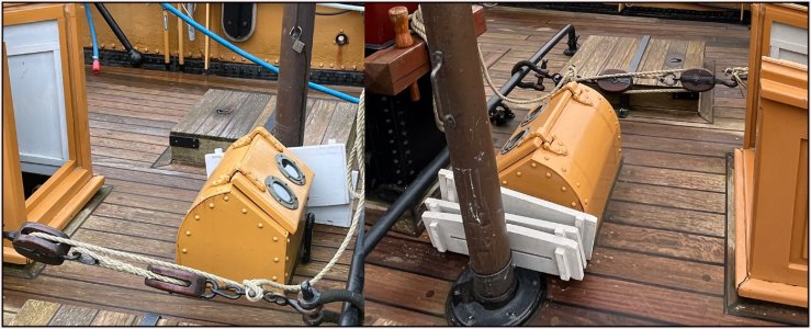

In the old drawings, this is called a 'lantern'. This is in contrast to the hood above the forecastle. That's called a 'schijnlicht'. I think it's called a 'sky vent' in English. It's the vent above the oven in the galley.

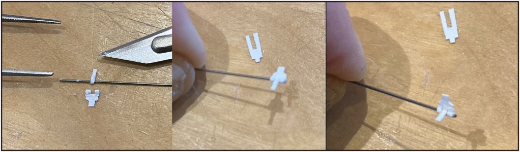

I cut both hinge parts from 0.15 mm Evergreen sheet:
And folded both parts around a piece of 0.5 mm spring wire. Then joined them together so they could still hinge. Next time I'll use the macro-lens .......
Then the following steps:
- glued the hinges to the hatch;
- folded them around the edge;
- secured the hatch on the right place on the hood;
- glued them to the hood and tested the hinges.
It still works and fits around the raised edge on the deck.

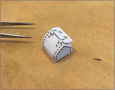

Fitted with rivets:
It's made of sheet metal, of course.......;)

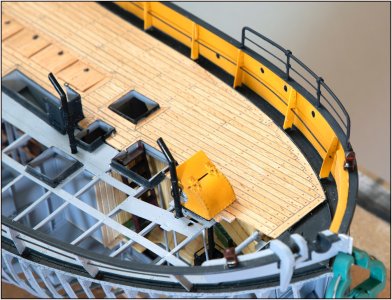

Then off to the paint shop:
Both round frames with window panes installed.
And joined to the others.
PS: Painted the three bulkheads of the access to the forecastle white....
