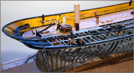

An overview photo:
So there also need to be detailed photos ....... ;)

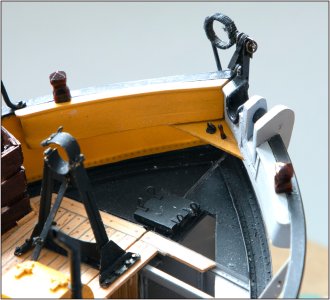

One of the cast iron bollards:
Equipped with the wooden back plate.
On the open side of the structure, I had to be creative (thanks AL-FI :)):
With the wooden plate with pre-drilled holes to attach it to the bulwark plate. Also with the interrupted lashing rail.
The double bollard on the foredeck and aft deck:
The bollard on the foredeck rests on a filler so that it just rises above the deck planks.
Meanwhile, the skipper also came to take a look on the building progress:
A real fisherman on wooden clogs, with an oilskin jacket and a "southwester."

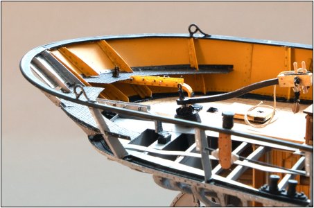

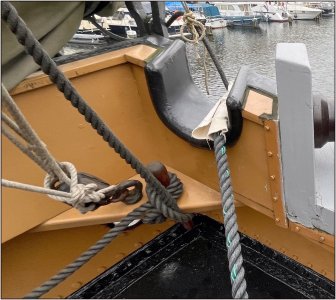

Continued with the components on and around the bulwark.
On the forepeak, the so-called "klapmuts" is located under both blocks. I have no idea how that little seat is called in English.
The jib tack is attached to the belay pin. When the sails are not set it's for common use.
On the model:
Only secured on the port side... because the two parts still need to be separable. Lacking decent belay pins, I made one myself. Just like the two on the tiller.

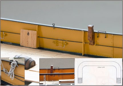

A little behind the mainmast, this bracket is located in the handrail:
- Two nuts on the underside to prevent it from slipping out. It took some fiddling before I could slide the M0.6 mm nuts onto the ends of 0.5 mm brass wire on both sides.
- I wasn't satisfied with the wooden bollard that I had coated with Schmincke "Brasil Brown." I removed it and coated it with linseed oil. At least the details are visible again.
-Now you can also see why the black bar halfway along the bulwark is called "lashing rail." The removed hatches can be lashed to it.
-Also visible is one of the six eyebolts on the handrail. Various hook blocks will be placed there. Another nine eyebolts are placed in various places on the deck. Maybe they will become visible later.

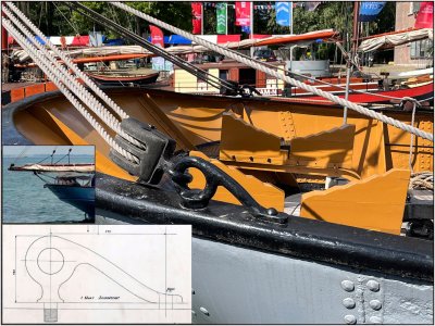

On both sides on the handrail at the rear are brackets for securing the mizzen sheets:
Here are the two-sheave hook blocks on both sides. I now have an idea of how the brackets are positioned around those blocks. That will be a bit of 'soldering-fiddling' again.
Can't wait to start with the rigging ......... ;)
