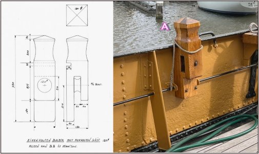

For hauling the 'reep', the rope on the 'vleet' (fishing nets), there's a wooden bollard with a disk:
The lashing rail is interrupted and secured to a little support on either side. Arrow A is shown in the overview photo that will follow.

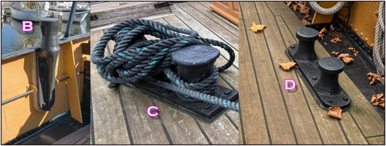

There are also three different cast iron bollards:
B: On both sides, three 'hanging bollards' secured on a wooden plate on the bulwark.
C: On the foredeck, only on the starboard side, a large bollard with two diagonal arms.
D: On the aft deck, on both sides near the hawseholes, a double bollard.

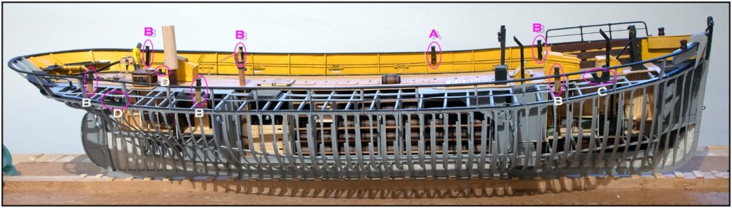

An overview photo:
So there also need to be detailed photos ....... ;)

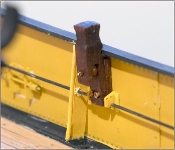

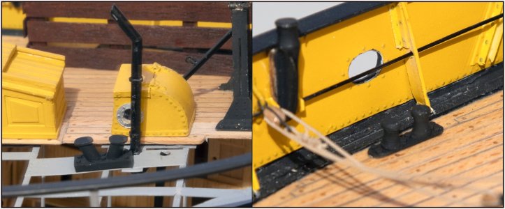

The wooden bollard:
With the interrupted lashing rail. There's still a lot of 'touching up' to be done, but that's for later.

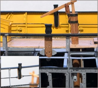

One of the cast iron bollards:
Equipped with the wooden back plate.
On the open side of the structure, I had to be creative (thanks AL-FI :)):
With the wooden plate with pre-drilled holes to attach it to the bulwark plate. Also with the interrupted lashing rail.

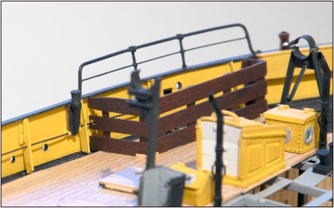

The double bollard on the foredeck and aft deck:
The bollard on the foredeck rests on a filler so that it just rises above the deck planks.
