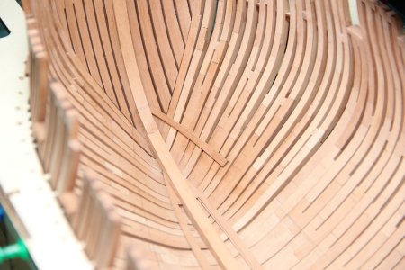

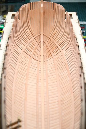

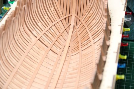

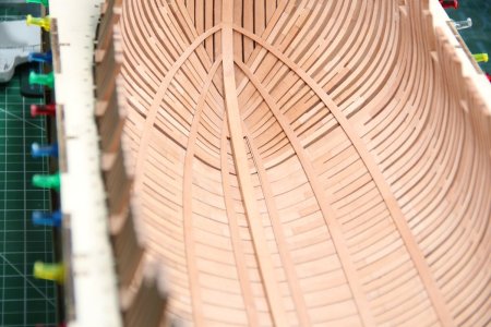

Arban,
As usual very nice, neat work.
One tip you may consider as you fair inside of hull, especially all forward cant frames. Mine came out fairly good side to side but if I had it to do over I would pull out lower waterways, pulled off of G4, primarily the stepped, curved forward pieces and use them for a template for interior curvature.
On mine, one side ended with very slight gap but that, likely, could have been avoided.
Tim
