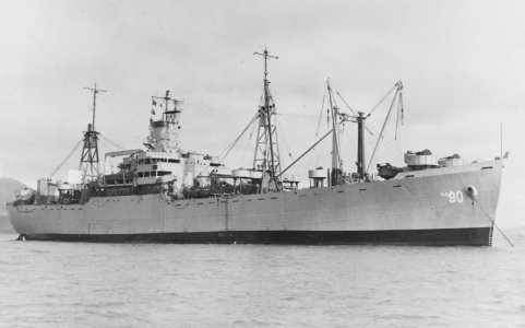

Another C2, this one's the USS Whiteside and is a U.S. Navy attack cargo ship.

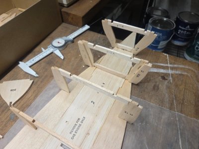

I plan to build the kit as a waterline model but rather than build the complete hull and cut it at the water line, I'm going to cut the bulkheads to the correct waterline height as I'm building. I've got a bandsaw so cutting the completed hull at the waterline wouldn't be too difficult but the balsa hull may be fairly fragile so I'm thinking it might be best to build it from the start as a waterline model and avoid the stress of cutting it.
I'm assembling the bulkheads but not gluing them to the base at this point - before I glue them to the base I'll shorten them so the base, which is below the waterline if the hull were to be built according to the plans, will be the waterline.
I may also finish the exterior of the hull in fiberglass - while my model will never see actual water, I believe I can achieve a much smoother and more realistic hull with fiberglass than trying to seal the porous balsa. I've got years of experience with fiberglass, having designed and built several custom hardtops and other body parts for Jeeps over the years, so coating the hull in fiberglass is no problem.
I finished assembling the bulkheads. They're not glued to the base yet, they're just setting in the notches in the base.
According to the plans, the balsa base is roughly 1 3/8" below the waterline. Since I'm building this as a waterline model, my next step is to trim 1 1/4 off the bottom of each bulkhead before gluing it to the base. As I trim them, I'll recreate the tabs on the bottom so the bulkheads will still assemble into the slots in the base.
Once the bulkheads are trimmed and glued to the base, I'll make a sub-base out of 1/4" plywood to strengthen the assembly. I mentioned above that I'll trim 1 1/4 off the bottom of each bulkhead, the extra 1/8 or so plus the thickness of the plywood base will provide a bit of reveal below the waterline for red bottom paint.

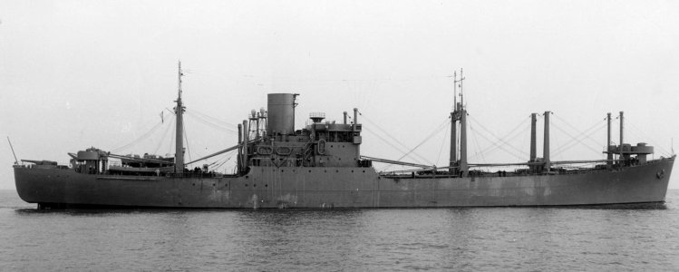

My ship in Little Creek, Va., was the USS Algol-AKA 59, ( as the one above) imagine this type would be a good choice. (AKAs were named after constellations, she now lies off the NJ coast).

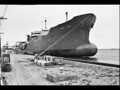

In your first and second pictures, it appears to be ships that are not fully loaded. It looks like the waterline is 8-10’ above the water.
The “waterline” of a merchant vessel can be a nebulous issue. While the Plimsoll mark defines the minimum freeboard that must be maintained, vessels hauling General Cargo can leave post not loaded fully to the “ marks.” Why is this?
Cargo has two related characteristics; weight and volume. A very light cargo will fill up a cargo space before the ship floats at its Plimsoll mark. Conversely a heavy cargo can bring her down to her mark with a partially filled hold.
A number of years ago I was involved in shipping a cargo of rubber lined large diameter steel pipe across the Great Lakes to its eventual destination, a mine in Indonesia. While the load filled up the ship to the point where she had a deck cargo, The resulting freeboard was such that it was necessary to load water ballast so she could clear a bridge in the Detroit River.

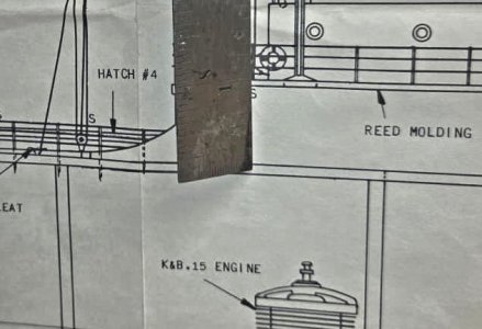

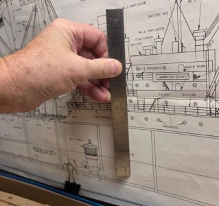

In that photo, visually it appears that the raised side by the deckhouse is the same height as the distance from the water up to the waterline, so I measured both on the plans. The rise by the deckhouse is 1":
Measuring down 1" from the waterline on the plans leaves about 1/2" to the bottom of the balsa base:
Since I plan to add a piece of 1/4" plywood to strengthen the bottom, I'll add 1/4" to that 1/2" and cut 3/4" off the bottom of each bulkhead before gluing them in place and that will result in a waterline model that looks like the photo above.

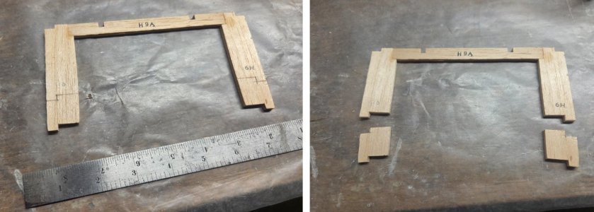

Here's more detail, I lowered the bulkheads today. I used a 3/4" wide scale to mark the locations for cuts to lower the bulkheads 3/4" and once marked I cut them with a razor blade.

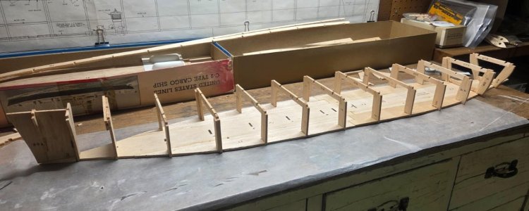

Work in progress, the five bulkheads in the center of the hull have been cut. The bulkheads still are just setting in place, not glued to the base yet.

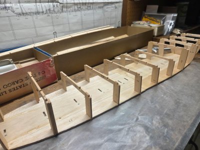

All bulkheads cut:
Due to the flare of the hull, shortening the bulkheads makes them wider than the base at the bottom. I planned for this - when I cut the 1/4" plywood I'll be using as a sub-base to glue this entire assembly to I'll cut to the proper contour to match the bottoms of the bulkheads.

As a past merchant mariner I love the insight into your loaded /unloaded conditions of your model.
In times past when we had to load a different cargo from what we had be carrying we would find the ship to be so far out of the water that it was difficult to walk forward from the stern as it was steep.
