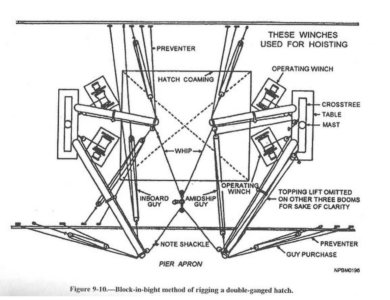

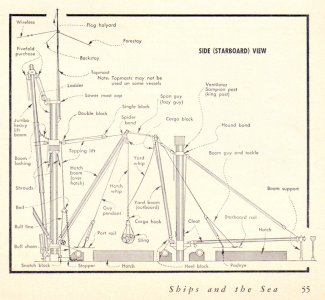

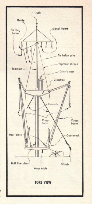

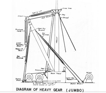

This is great info! I can use it in mine as well.Here’s a few drawings of cargo gear arrangements that may help if the plans are not clear enough

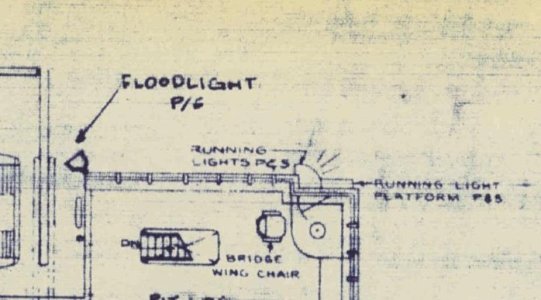

With a little more searching I collected these images showing where navigation lights need to be placed so I'll add LEDs in those positions and appropriate wiring to power them.Planning ahead... does anyone have any references on the navigation lights that would typically be used on a cargo ship like this? I did some Google searching but didn't find anything useful that applied to this type of ship. What lights would a ship like this have and where would they be positioned? I'm considering adding LED lighting to the model but want to get it right. Also if there's information on lighting that might be on the ship while it's at the dock for loading/unloading that would be helpful too.
Thank you! The drawings are very helpful, both running lights and other lights are shown. I'll build accordingly.look at Sheet 5 - Top of Houses, Bridges, Boat & Cabin Decks in this link as it shows light locations.
AKA-107 USS Vermilion Booklet of General Plans https://archive.org/details/aka107bogp1968
