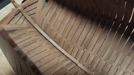

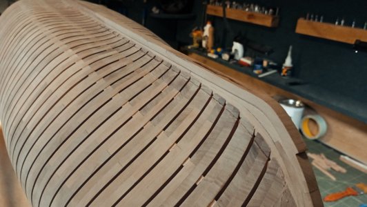

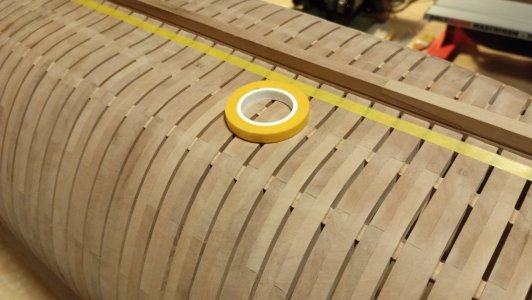

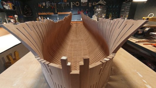

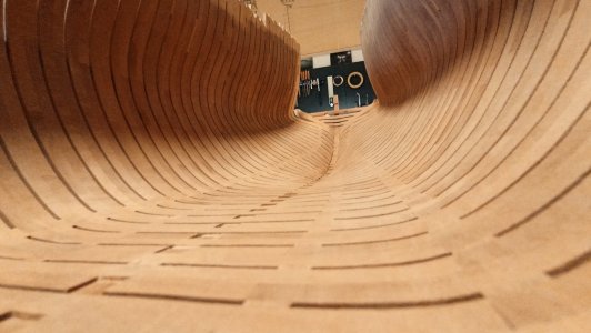

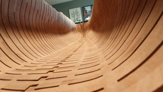

The internal sanding is now complete. The first pictures show the sanding process until a uniform surface is achieved.

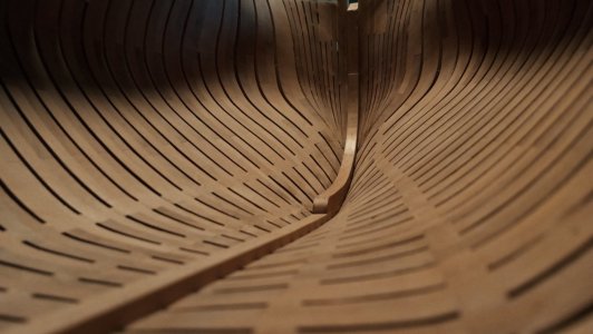

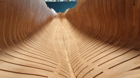

The small filler pieces between the frames were given their final shape to allow water to flow towards the keel. This was done using a Dremel tool, a 1mm milling cutter (right) and a 2mm round milling cutter (left, the finished shape).
The nostrils were also made at the same time. The measurements were transferred to each frame individually and produced using a milling cutter and square file.

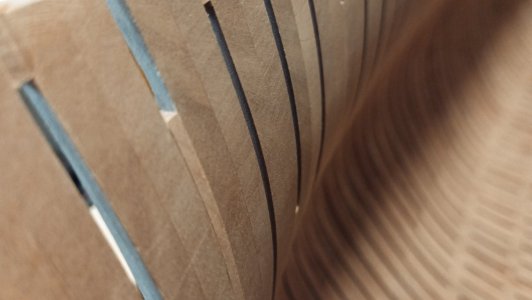

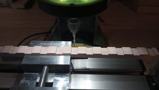

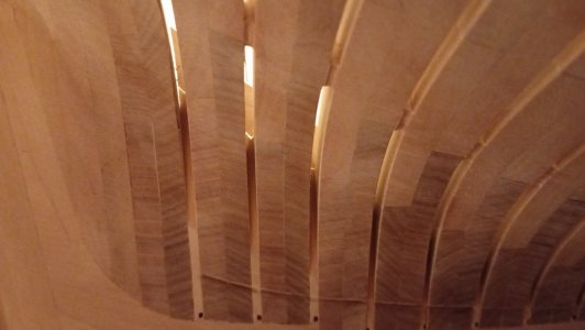

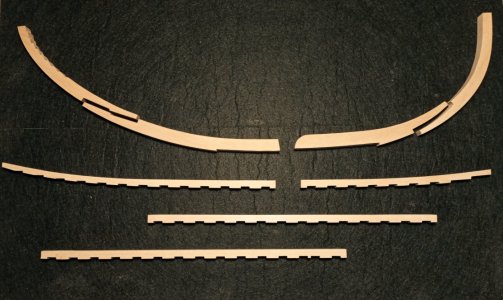

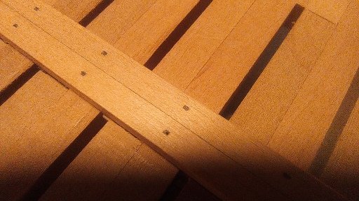

Now let's move on to the (two-part) keelson with its slurry sticks. These were milled according to the plans and installed after further adjustments to the ship. I spent a long time considering how to implement the bolt on this ship. A dark square piece of wood, 0.8 mm thick, for milling or cutting to size. I couldn't find any fiberglass square rods in these dimensions either. I have silver or brass wire available as square pieces, but I want to keep the bolt dark this time, which also rules out bluing it later. So I decided to use a steel sheet cut to size and carefully press it into the wood, where the square hole will be filled with wax. I adopted the bolt arrangement from the French 1:36 scale build log.
Thus, this work is also completed, and I can once again fully dedicate myself to the rear design.

Looks good Andreas - I too wanted a darker bolt as well on my build. However I just used nickel square wire on the hold planking in the hopes it will tarnish over time
This could be a great idea to use to simulate treenails - I may have to experiment with this technique.
Incredible result with the dark wax filling the square pressed in holes.
Did you use a scraper to remove any excess wax? I would think sanding or rubbing would spread the wax into the surrounding wood...???
