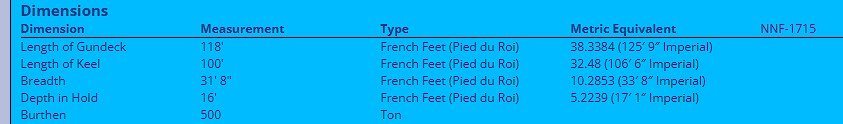

Hello! You're making a very cool model!I wanted to ask, do you have the dimensions of the ship as shown in the picture?
I don't see such dimensions in the drawing, please help.
