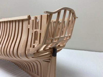

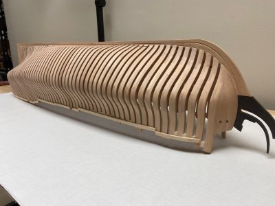

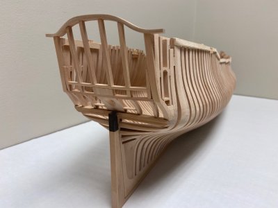

Very clean work, a really good decision not to open the hull. As you said, it would ruin the beautiful lines. That's also why I didn't do it with La Palme. Regarding the angled pairs of planks, I think the decision is perfectly understandable; if I ever build it, it will be in 1:36 scale.

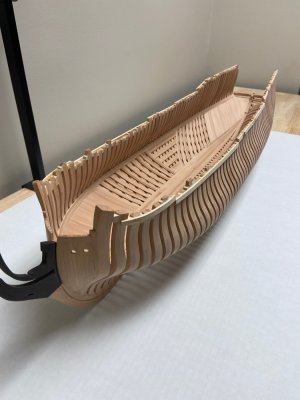

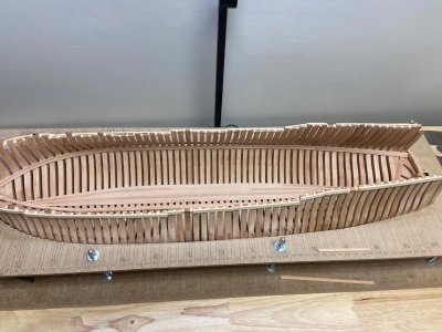

Thanks guys - Brad I bought some brass half hard square wire 4mm off amazon. It doesn't look much different than the nickel wire I used on the frames so no need to blacken it - just let nature take its course. I also bought a good pair of miniature bent nose needle plies with the serrated jaws for grip which made the job much easier to insert the wire.

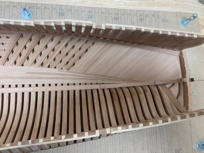

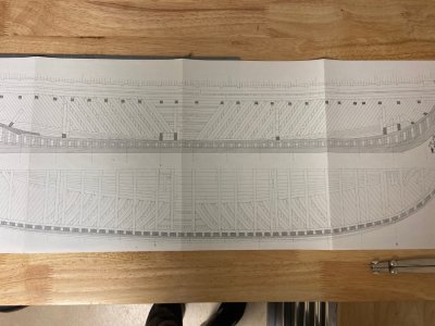

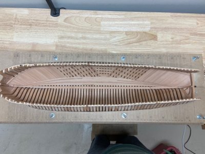

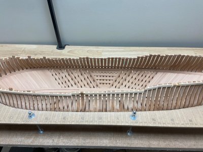

I just mounted the horizontal planks which will act as the ceiling to the diagonal planks. Realizing nice tight angular joints will be tricky enough to accomplish without the notches. The 2 D plans make the job look much smaller than it actually is.
I'll be using 20 gauge wire like I did on BHR for the keel bolts. 0.8mm/.032in which equates to just over a 1.5inch bolt head. I saw Uwe use some square nails and liked the effect but for such a small boat as the Salamandre, 20ga should look appropriate.
I'm glad I don't have to deal with diagonal planks. Those angles will be changing slightly with every plank!!! I'm sure you'll find a rhythm and some unique ways to make them. Good luck, we'll all be waiting to see how you nail them!!!

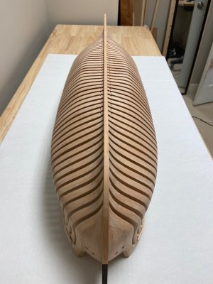

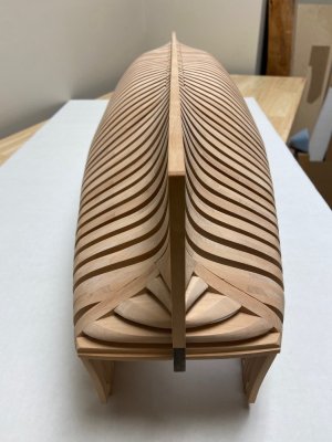

Simply WOW! You nailed those complicated and ever-changing angles. It really looks beautiful
Will be fun to have it out of the jig as you start to fair the outer curves!
Absolutely beautiful hull lines!
The patience and skill in creating them is most impressive!!

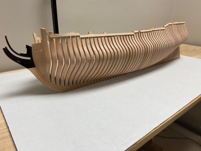

Is the bottom of your eel channel profile rounded or squared?

Brad the portion of the eel channel you see was cut from my mill cutters (1/16 I believe) when I built the frames. It should be square. I will probably touch them up on the port side which will not be planked and visible when I continue the channel to bow and stern after the wales are installed.
