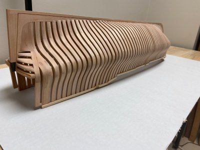

Very clean work, a really good decision not to open the hull. As you said, it would ruin the beautiful lines. That's also why I didn't do it with La Palme. Regarding the angled pairs of planks, I think the decision is perfectly understandable; if I ever build it, it will be in 1:36 scale.
Chris,
Good to see an update on your superb build!!! As usual, you are several steps ahead of my Salamandre and I will continue to glean tips and techniques from your great log. Your accuracy, clean cuts and planking are an inspiration to us all.
The treenails on the planking are executed perfectly!!! What size wire and material did you decide on?
Good call foregoing the notches...wouldn't it be nice if it were full size and you could swing a hammer and chisel them with no worries!!
Do you plan on putting bolts on the keelson? I'm close to laying the keelson and have been working on bolts. I plan on 2/frame and will leave them slightly proud of the surface vice flush, like treenails.
Thanks for sharing your awesome build in such detail and with great photos.
Thanks guys - Brad I bought some brass half hard square wire 4mm off amazon. It doesn't look much different than the nickel wire I used on the frames so no need to blacken it - just let nature take its course. I also bought a good pair of miniature bent nose needle plies with the serrated jaws for grip which made the job much easier to insert the wire.

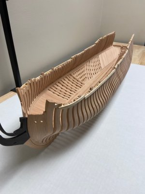

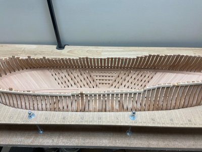

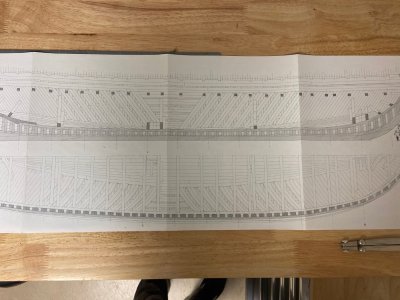

I just mounted the horizontal planks which will act as the ceiling to the diagonal planks. Realizing nice tight angular joints will be tricky enough to accomplish without the notches. The 2 D plans make the job look much smaller than it actually is.
I'll be using 20 gauge wire like I did on BHR for the keel bolts. 0.8mm/.032in which equates to just over a 1.5inch bolt head. I saw Uwe use some square nails and liked the effect but for such a small boat as the Salamandre, 20ga should look appropriate.
I'm glad I don't have to deal with diagonal planks. Those angles will be changing slightly with every plank!!! I'm sure you'll find a rhythm and some unique ways to make them. Good luck, we'll all be waiting to see how you nail them!!!

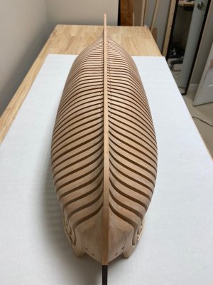

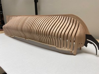

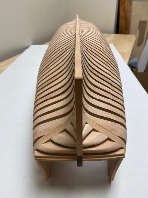

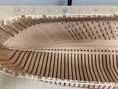

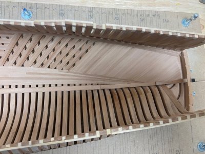

Good morning group - update time. The diagonal planks are installed but not nailed yet. I will revisit this when I proceed with interior construction.
I will now remove the model from the jig and fair the exterior. I will soon now if my hard work over the past year is successful.
Simply WOW! You nailed those complicated and ever-changing angles. It really looks beautiful
Will be fun to have it out of the jig as you start to fair the outer curves!
Absolutely beautiful hull lines!
The patience and skill in creating them is most impressive!!
I saw the single blemish you incorporated to prove your mortality (or maybe it was a speck of dust on my computer screen)? ROTF
Is the bottom of your eel channel profile rounded or squared?
Love the pictures, they are inspiring...thanks for sharing.
Thanks for your compliments and likes ! I am humbled by them.
Brad the portion of the eel channel you see was cut from my mill cutters (1/16 I believe) when I built the frames. It should be square. I will probably touch them up on the port side which will not be planked and visible when I continue the channel to bow and stern after the wales are installed.

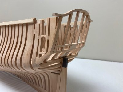

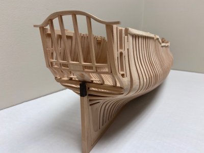

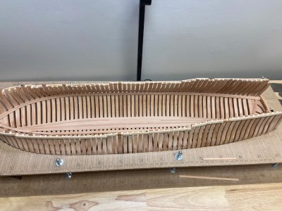

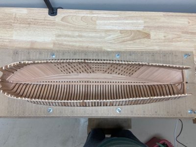

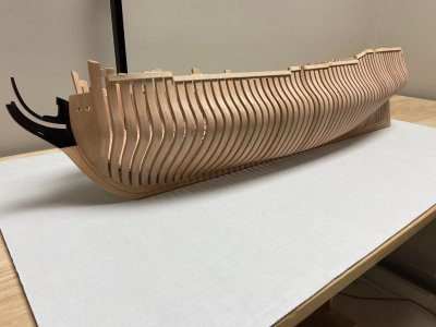

Good Morning the stern has been installed which was not as difficult as the bow ! The crown rail at the top of the stern timbers will need to be thinned a bit later The rail extends to allow for the quarter gallery structure later. At this point the framing is complete and wale installation is next up.
Looks like another home run! It really completes the lines and structure beautifully!
Those beams "sticking out" from the crown rail look delicate and ready to jump out and snag "something"!
Any way to extend those temporary bracing beams from the top of the frames to the lonely ends of that beam, so it has some support/structure.
Look forward to seeing the main wales. Any hints on type of wood or stain treatment?
Thanks for updates on this awesome build!
Thanks Brad - believe me the crown rail and is mounted solidly to the stern timbers. I just need to be careful not to snag them on anything.
In terms of the wales - the fully planked side of the hull will have black hornbeam wood I bought from Vahur in Estonia. Its supposed to bend easier than ebony - we'll see soon enough. The wales will be Pear on the unplanked side.
