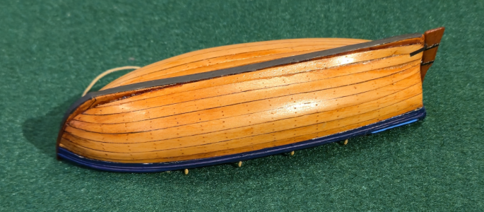

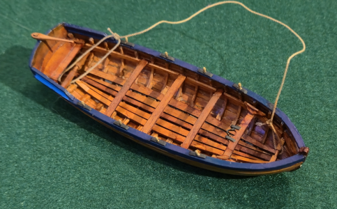

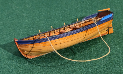

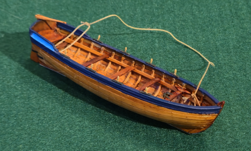

Yeah, although a lot of it is the kit. The Nikitin kit was in walnut and the hull planks were not long enough, so stopped short each end. But yeah, it is much better, thanks.That's an impressive amount of improvement! Bravo!
That is exactly the idea. ;-)Hopefully the mast and sails on one side will balance the oars on the other and keep the ship upright and level.
