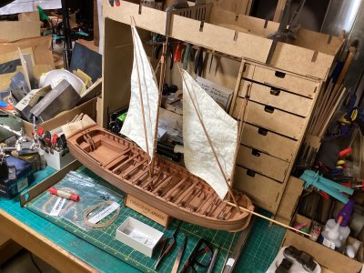

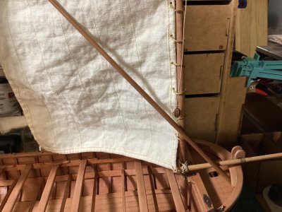

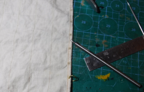

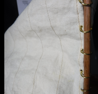

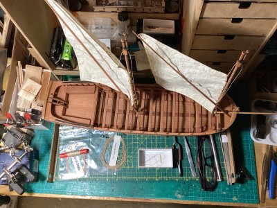

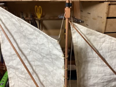

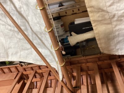

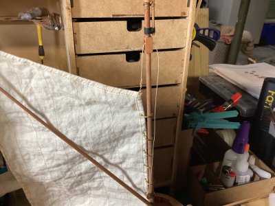

Sails ... today I punched all the 1.2mm holes in the foresail and then installed the rings to mast and sail. Before punching them, I'd glued the cloth in the hem together with 50/50 white glue. The rings are 1mm thick.

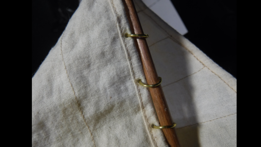

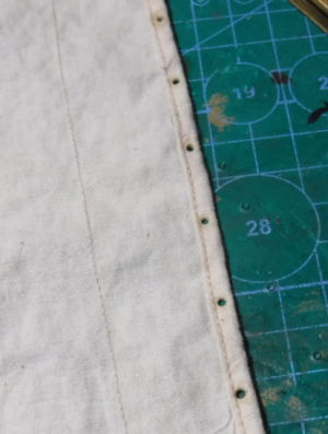

I had tried just pushing a pin through the material and shoving the ring through that - didn't like it - the splice in the ring caught on the cloth in the hole - and it just didn't look right. Fuzzy holes. And I'd tried punching holes in the sails without stiffening the cloth with glue first - those were fuzzy holes too. Here's a pic with 1mm fuzzy holes punched into non-glue stiffened cloth.
Tried the 1.5mm punch, but it took up too much of the sail. The 1.5mm hole is at the bottom in this pic. The rest are 1.2mm. These were, of course, glue stiffened holes.
I bought this set of 9 punches off of Amazon
  • They worked fine on the sailcloth that came with the kit. I like em, IOW. But note that I haven't tried em on anything else.
Here's how I glued the holes - while using tweezers to push the rope inside the hem out to the edge of the sail, I dipped the tip of the spatula into some glue and massaged it into the sail where the hole is to be punched - this was to glue both sides of the hem together before punching - to make a cleaner hole.
Next - the mainsail - waiting for the glue stiffened holes to dry so I can punch em.

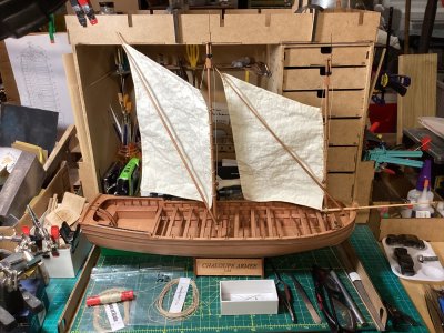

Rigging ... bent some brass into some tiny hooks, Finally found the tiny block (had no extras) I'd lost over a week ago, it just popped out of my fingers like soap. And I stropped the hooks and blocks to two lines running up the main and fore masts, and through the blocks at the tops of both of those two masts, and they then hook into the tops of the sails. Like this ...
IMG_6054.jpegIMG_6052.jpegIMG_6051.jpegIMG_6050.jpegIMG_6049.jpegIMG_6048.jpegIMG_6047.jpeg
Next, the lower blocks that these blocks tie into.
Cheers.

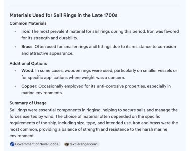

I think they would have been wood, but could be wrong
Good call. I did some research, and they used all sorts of material ...
But as I was searching, I noticed that the results changed somewhat, according to my phrasing ... so ...
This is one area that you can't trust AI summation. It is best to have primary or secondary research material on hand to answer questions like this. It's why I wish I had a set of the ANCRE drawings of the longboats.

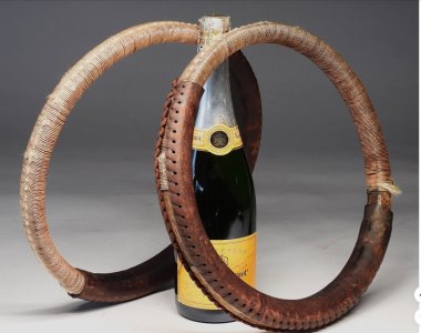

And some full size antique mast hoops I found on ebay ... made outta wood, rope, leather with metal fasteners.
Also full scale, but smaller ... for 1.5" spars.

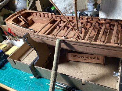

Mounted some cleats to the gunwales. And just got my first line rigged. It raises and lowers the mainsail. My rigging skills lag my wood working skills, by quite a bit ... so it is coming along slowly.
Showing the wooden dowel I used to coil up the rope hank hanging from an oar lock. At first, the rope loop wouldnt slide off readily, so I put a slight taper to it. And now the loop of rope slides right off. That dowel is normally my inside the curve sanding block. I roll up the rope by rolling the stick, so that it has no bias to it.
There is enough line on the hank, to lower the mainsail. I like working rigging.

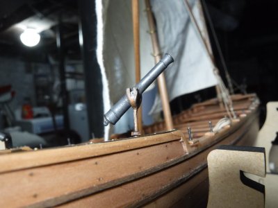

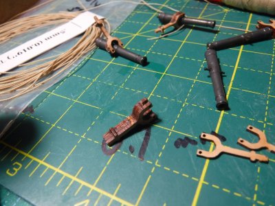

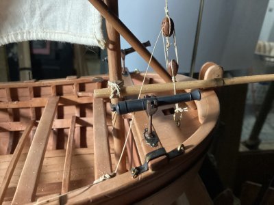

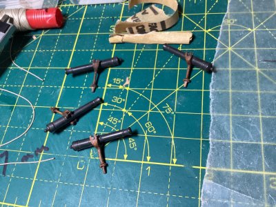

Cannon Mounts - almost done, except that the two pins securing the cannon to the cradle in the mount are not yet glued in place.
They begin like this - 3 pieces sandwiched together ...
And go through some stages
Before ending up like this - I stained em real dark, rather than painting em black as plans suggested. This is before I cut out 8 pcs of 4.5 x 0.8mm brass rods, blacked em, and inserted em into the cannon securing holes in the cradles.
This is with the pins in em ...
And finally, mounted cannon with pins ...
