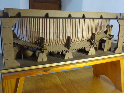

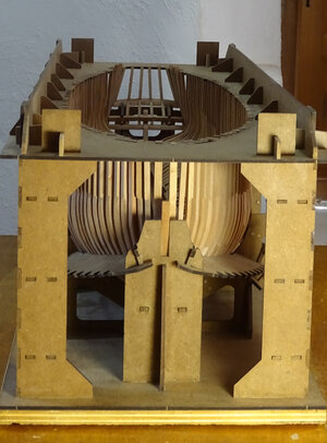

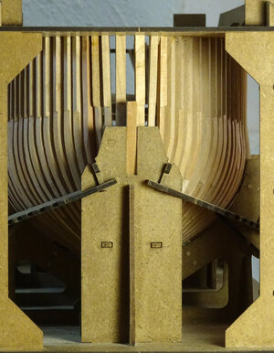

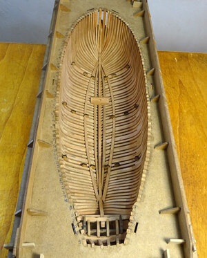

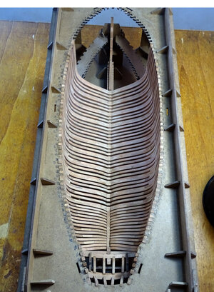

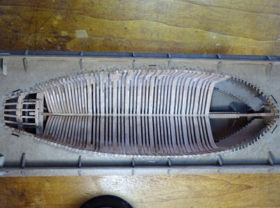

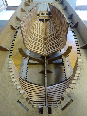

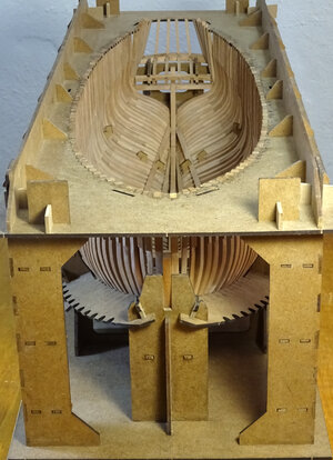

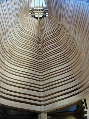

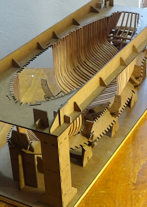

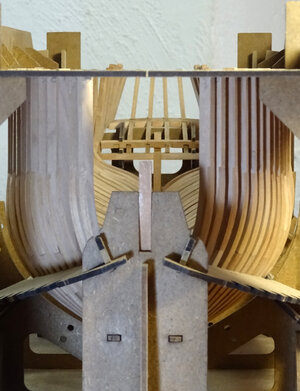

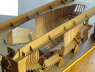

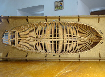

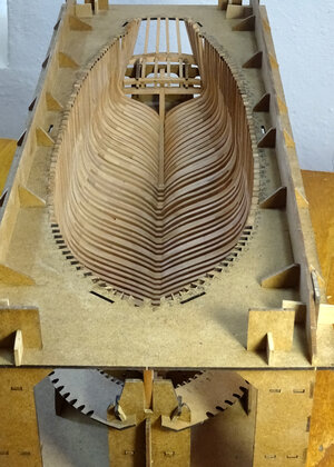

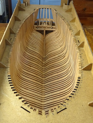

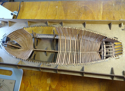

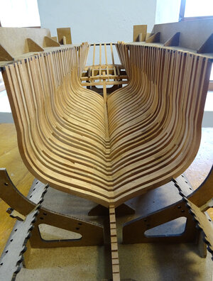

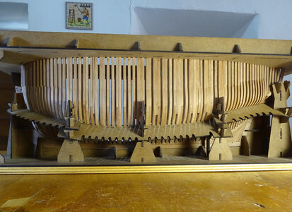

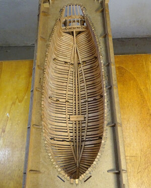

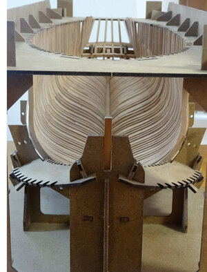

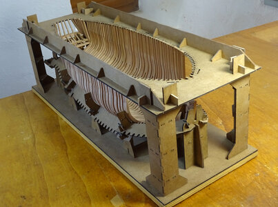

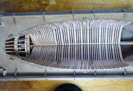

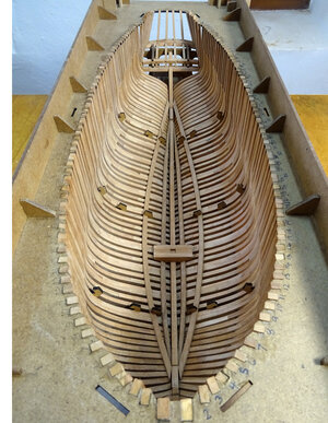

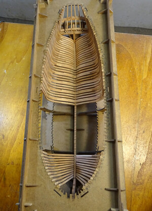

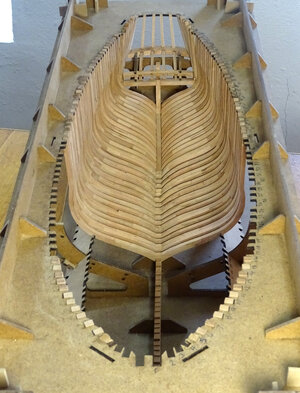

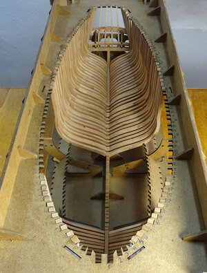

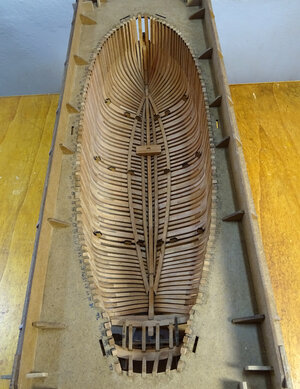

More ribs and slowly closing the gap. The hull is really taking shape now, which will be better seen when it is cut down from the extention pieces joining it to the cradle. These midship ribs consist of double, single and half (filler) ribs. In the making of these, l have found that for some reason all the slots in the floor timber sections that attach to the keel have been made at least 1 mm too narrow, so have to be enlarged to enable them to slot over the keel. This has to be done with great care, as the bits that are left are extremely brittle and are apt to break off at any time as l have found to my cost on a few occasions
